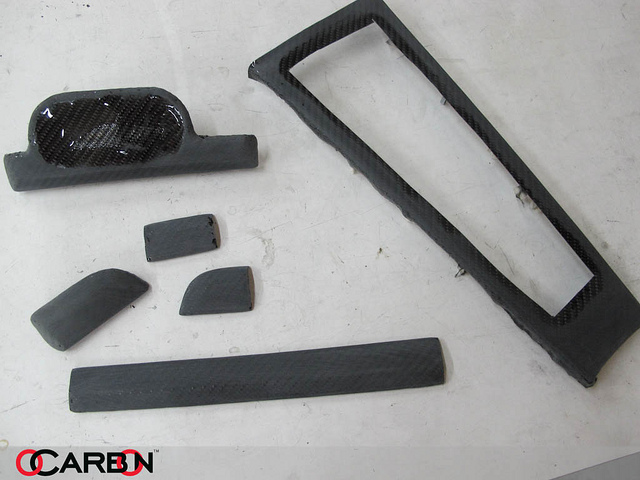

Work in progress. New pics received from Matt @ oCarbon.
Parts will get another few coats of epoxy. Then they need to cure for a week or two and spend some time in the oven before they get fully trimmed and sanded.
Patience will eventually be rewarded

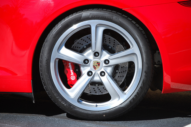

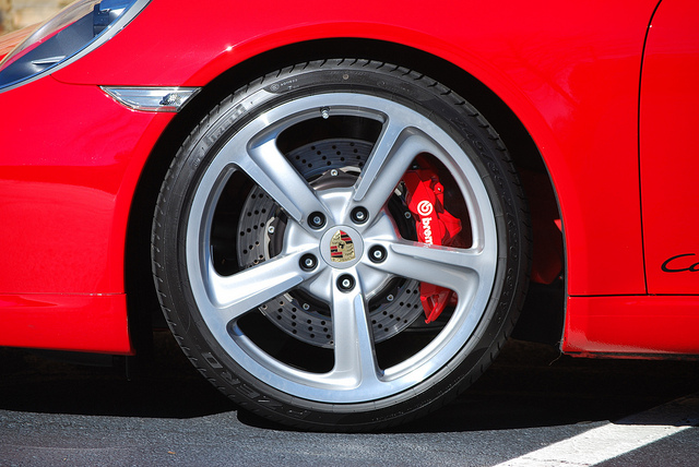

I am running a Brembo Gran Turismo 15" BBK at the front and the rear with HP2000 pads. I killed a full set of stock brakes -glazed and warped rotors- last summer at Barber during a very 'hot' week end. Stock brakes are OK for a normal use. If you push the car to the max and use track tires, I'd recommend to upgrade the brakes. The Brembo BBK is perfect with no fading, even under the most intense use.

Probably a bit less. Take also into account that you can resell your stock brakes to a 3.4 Carrera owner who wants to upgrade or sell your BBK when you trade the car in. Not more expensive than PCCB, works just as well on the track with much lower costs in case of issue (rotor to replace, etc...).
Definitely expensive but makes a lot of difference on the track. Works too well in fact as I almost got rear ended a couple of times in emergency braking situations

There was no other options for the brakes when I got the BBK. I think Yellow Pagid pads may be available now. You could give it a try, go for stainless steel lines and use a higher performance brake fluid as a starting point.
I think Brembo also makes 2 pieces direct replacement rotors now and you could start by upgrading the front rotors only. Going for these options would probably cost a bit more than $3k with labor and could probably be enough.
In my case, I wanted to play it safe and be sure that I could go as crazy as I wanted without to have to worry about braking power
PS: one of the issues I had with the stock brakes is that the holes of the drilled rotors got totally filled/blocked with brake dust after the first session.

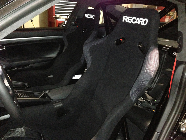

I stopped by at Freed Performance today and they were installing a bbi rollbar, Recaro Profi seats and Schroth harnesses in the 991S of my good friend and track buddy David. The result looks good and seats are easy to swap (4 bolts by seat and that's it). I am also swapping my 18 ways comfy stock seats with GT2 seats for the track and it is a good option... as long as PCNA does not import 991 bucket seats
