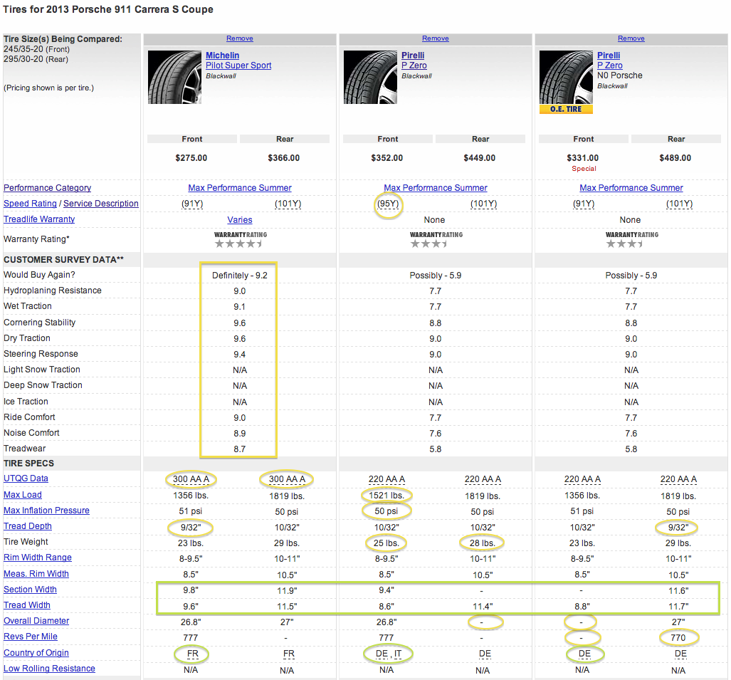

Resurrecting this thread because, after almost a year of happy cornering, my OEM P-Zeroes are pretty threadbare, in particular the rears.
Attached is TireRack's comparison of the Michelin PSS, Pirelli P-Zero (non-N) and P-Zero N. (Data where only one tire differs are marked yellow and data where all three tires differ are marked green for easier parsing.)
Assuming the data TireRack gives for the tires isn't totally off, four things jump out at me right away:
  1. Their Customer survey ratings are much higher for the PSS.
  2. The PSS is designed for less thread wear (300 vs 220). Assuming thread wear is roughly proportional to grip, this means less grip for the PSS.
  3. The non-N and N-spec P-Zeros actually differ significantly. In particular, the non-N-spec P-Zero has a much higher front load rating and weighs more in front and less in the back. Section and thread widths differ throughout.
  4. There is no significant difference in price for a set of non-N-spec ($1,602) and N-spec ($1,640) P-Zeros.
Seeing that both the PSS and non-N P-Zero are sold for many vehicles, not just the 911, doesn't this support the N-spec-leaning camp? In particular, there doesn't seem to be an "N-spec markup", it seems P-Zeros are just more expensive.

Re MPSS, speaking from my 997T4S experience, it's a no brainer for replacements - they are so plush and grippy. Also, FWIW, I was in the Ferrari showroom on Park Ave this week and noticed most of the new models sported MPSS.
