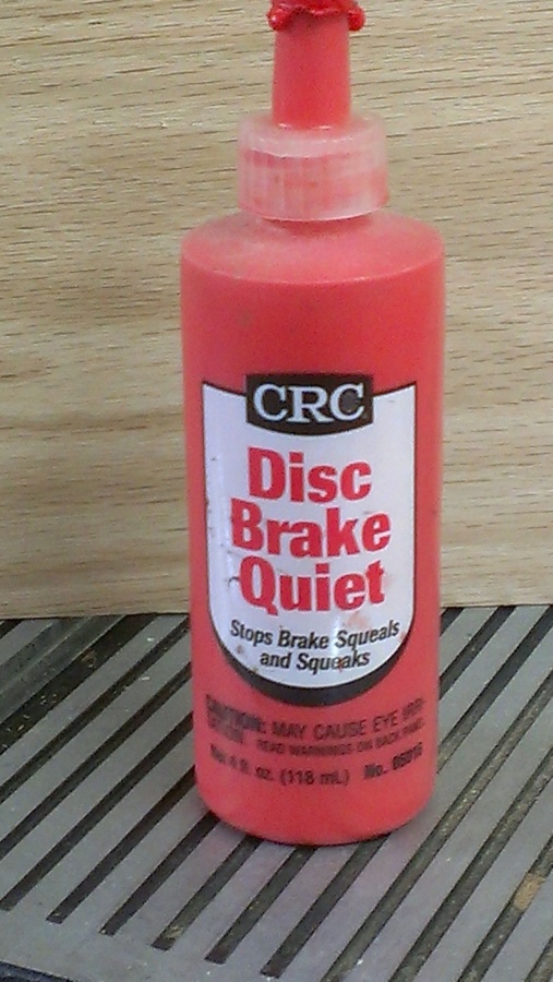

You'll probably find you'll have to do the bedding every once in a while. I haven't had to use the full episode to get rid of the problem. There's also a brake squeal product that I had put on before the bedding.
