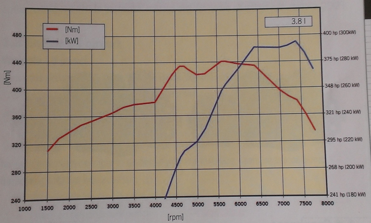

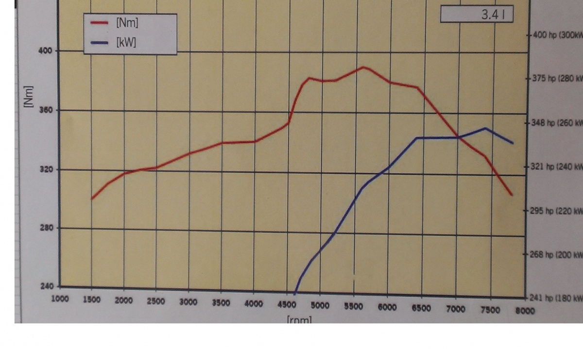

Originally Posted by mtony
My 911S will creep like an automatic transmission equipped car when I release the brake. Is this normal? Other DCT equipped cars do not creep when releasing the brake. This is not really an issue, but even after 300 miles, my car smells like burnt clutch after driving it, and I'm having a some slight hesitation when accelerating between 2600 and 3000 RPM.
1. PDK creep. The 997 PDK completely releases the clutches at idle and is anoying when you go from a stop because the clutch grabs at just above idle. The 991 PDK has a more sophisticated engagement that stays partially engaged at idle, then depending on demand engages at different rates. For example, if you accelerate hard, it will slip to 3500 to get up to the good torque range (at least in the base model, I'm not sure about the S). Presumably, because the wet clutch is cooled better in the 991 they can afford to have it slip for performance starts so you can get up on the torque curve.
2. Burning smell. Addressed a couple of times above.
3. Hesitation. My base model doesn't hesitate at all, but check the thread on hesitation. The torque curves are attached.
