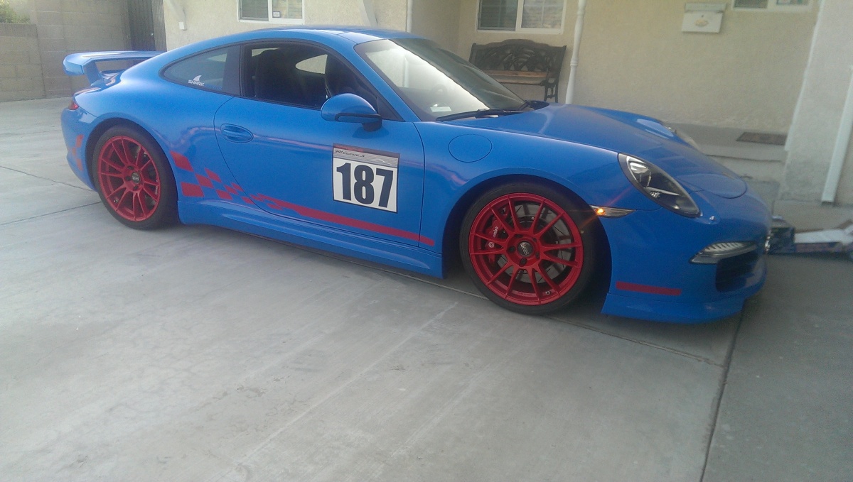

I put the 19in OZ Ultraleggera's on this weekend. I was a bit concerned about clearance with the control arm and my 380mm brembo kit but they fit with ~2mm to spare.
I'm happy with the turn out but the gap in the wheelwell is pretty bad. I'm excited to see how the r888s perform next weekend at Thunderhill.
Some springs will fix the gap in a hurry.

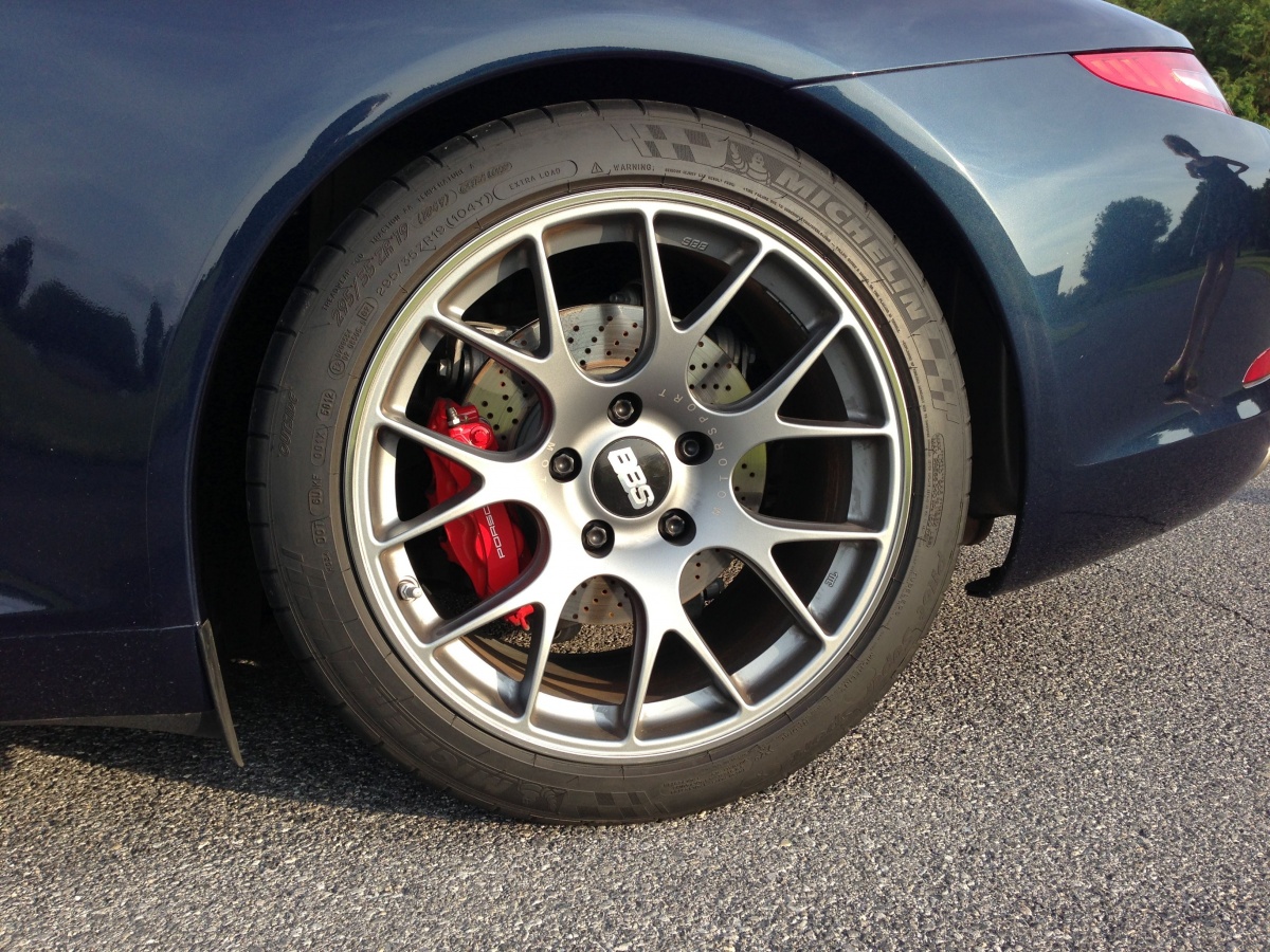

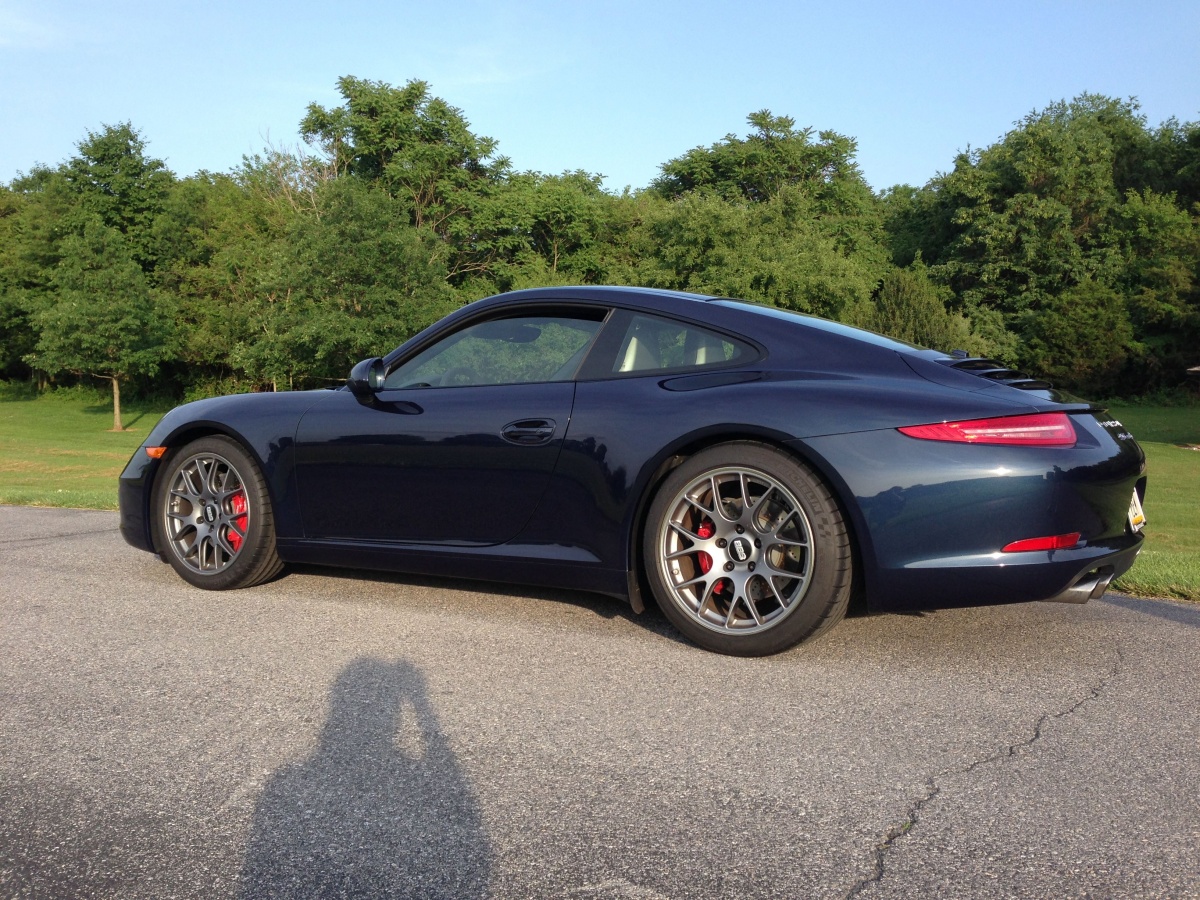

Bbs CH-R 19"
Hopefully I did this right. Two pics of the BBS CH-R 19" wheels.
Fred S

looks good. Why didnt you go w/ 305's?
No one really makes a 305/35/19.
