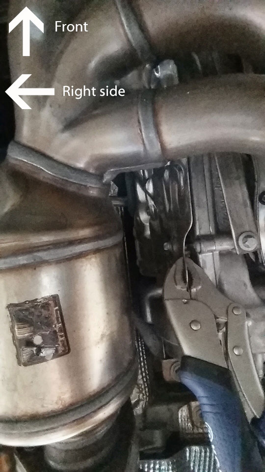

Ok guys, I *may* be making some progress here. Perhaps some of you could try to reproduce the little experiment I ran today. First, here's my logic about the vibration:
  • Doesn't occur in Neutral = rules out pure rotational frequency issues, ie. the engine
  • Occurs within a very tight RPM range (3000-3300) = rules out cam timing components
  • Happens with and without SC = rules out motor mounts
  • Happens with base exhaust, PSE, and aftermarket pipes = vibration is probably upstream of the center muffler
  • Seems to happen only with specific throttle input = probably exhaust-related
So going with these assumptions, I got under the car to see if I could find anything that might be prone to vibration. The first thing that caught my eye was the heatshield next to the side muffler. Just for kicks I clamped a vice grip onto it (pic) to change its mass and went out for a drive. There was some traffic so I couldn't test it extensively, but I could not get the vibration to occur! Usually its very easy to reproduce the vibration.
At this point I'm still skeptical of my experiment because of the lack of testing, but I'm hoping some of you could maybe try this as well. I probably won't get another chance until tomorrow at least.

Founder's post:
This is some good work here. When I examined the heat shields I just checked for looseness and metal contact. I never considered changing its mass. It could be that it is just vibrating at a certain RPM and torque load. I will try to get my car on a lift this weekend and try to reproduce your results. Can you tell me which shield is the one that you played with? I think the sound is coming from the rear right side, but its tough to be sure.

Originally Posted by 991carreradriver
Founder's post:
Yeah it felt like the right side to me too so I clamped the passenger side and got the posted results. BTW you should have enough clearance to get to it without a lift.
So it seems that the shield may be vibrating and touching the side. Reasonable since the clearance is very tight. I am going to place a small shim in there. It won't survive heat long term, but it will confirm or eliminate the solution. I will jack up my car this weekend and shim it. Stay tuned.

I am still going to work on the shield, I am trying to figure out what the wedge should be made of so I don't self immolate. I want to make it a permanent fix as I suspect it is the culprit based on sound and the vice grip test result.

Originally Posted by hawc
So glad to hear it's not something inside the engine! Also is it just the heat shield on one side? I assume the identical heat shield is on the other side, but no noise from there?
Stay tuned but it looks like the back right side.

Hey guys, just wanted to reiterate that this is still a work in progress, so don't go making any fancy permanent shims/clamps yet I haven't been able to experiment further since I last posted on 10/29, but hope to get to try again within the next 10 days.
If you can or can't reproduce my trial fix, please share your results here in the name of science.
