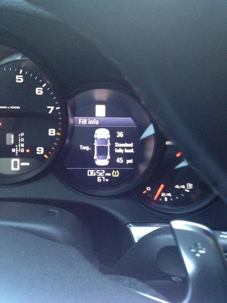

[IMG][/IMG]
To add to my previous post.
I lowered my rears from 45 to 44 and it still says -1 or sometimes even -3. I went in to reset it to 20(S) so I got the message that it is determining my PSI and once it calibrated it said my front is 36 and my rear is 44.
Odd that the computer thinks that the ideal is 36 front 45 rear no? Am I looking at this correctly?

Worth noting that I had a screw in my front passenger and rear passenger tires that got patched. Tires hold air perfectly and show consistent from 36 and rear 44 but the fill info is what's bugging me. The front's show 0 but the rears rarely show 0. Due to miss calibration in the computer?

Any thoughts? Can patching a tire affect/change the settings in the TPMS?!?
