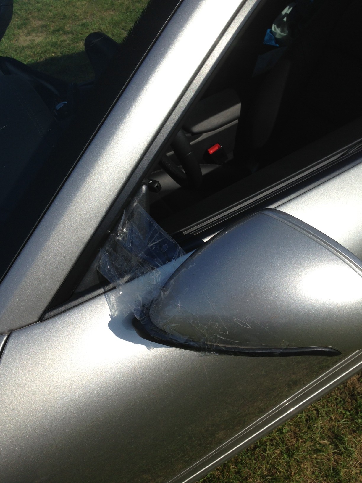

I love this car but the wind buffeting on track with driver’s window down SUCKS. It is loud and distracting. I was looking for a quick fix. I didn’t want to spend a lot of time to find out that it didn’t work. This looks terrible but worked well. I had significantly reduced noise in the cabin at speed. How come Porsche didn’t fix this? I hope someone on this forum can come up with something better.

Name:	Porsche 991 winddeflector.JPG

slightly tilt the sunroof. Buffeting goes right away. Although now you have to worry about rock chips on the sunroof!

Many groups won't let you run with sunroof open. Opening passenger window doesn't help either.

Nice fix, should of done that on Monday, the wind buffeting drove me insane

Is that standard packing tape in the pic?

Yes. It is not really a great fix. I was running late and did it just before I jumped in the car. I will try something better this year.

it is still an issue...and not just for track driving. i was out earlier in the week when we had some nice weather. i had both the driver's window open and the sunroof. mad buffeting at 60mph and above.
someone needs to design a fix. either an economical mirror cover OR perhaps a triangular extension to the small triangle piece at the corner of the driver's window that deflects air outward. i noticed that if i put my hand in the space between the mirror and the door at that location the buffeting disappeared.

Based on the videos and reports of owners, the new sport miror does not fix the buffeting problem in the least.

I have been annoyed by that same problem. I took a piece of stiff cardboard, cut it into a rectangle and slid it between the door and the little quarter window on the passenger side. The cardboard extended from the window to the mirror, similar to your tape, but was not attached to the mirror. It was enough to stop the buffeting, even with nothing on the driver's side.
High tech? Certainly not. But free and removable. There are folks who are coming out with more permanent solutions as well. Here is one that looks great, but is not inexpensive:
