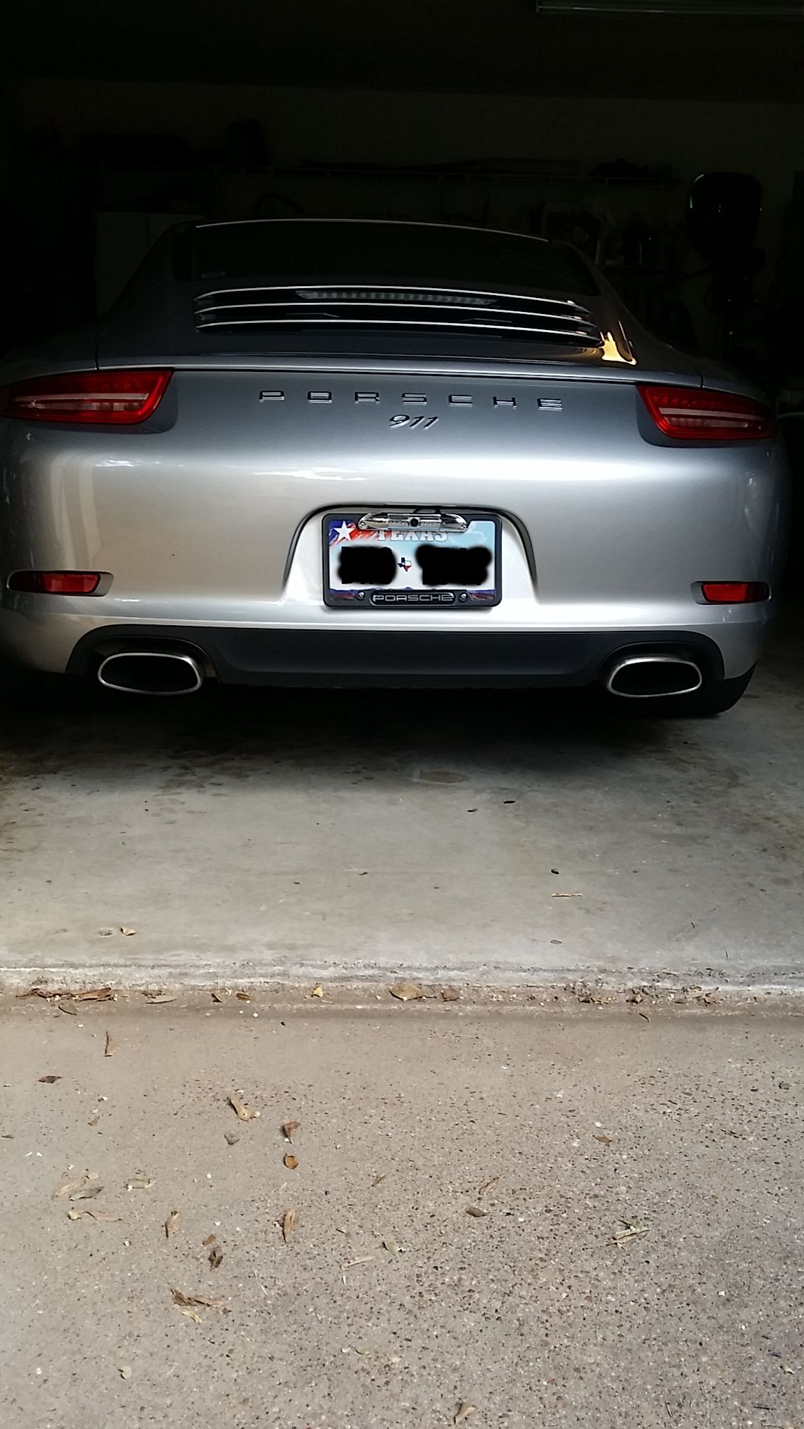

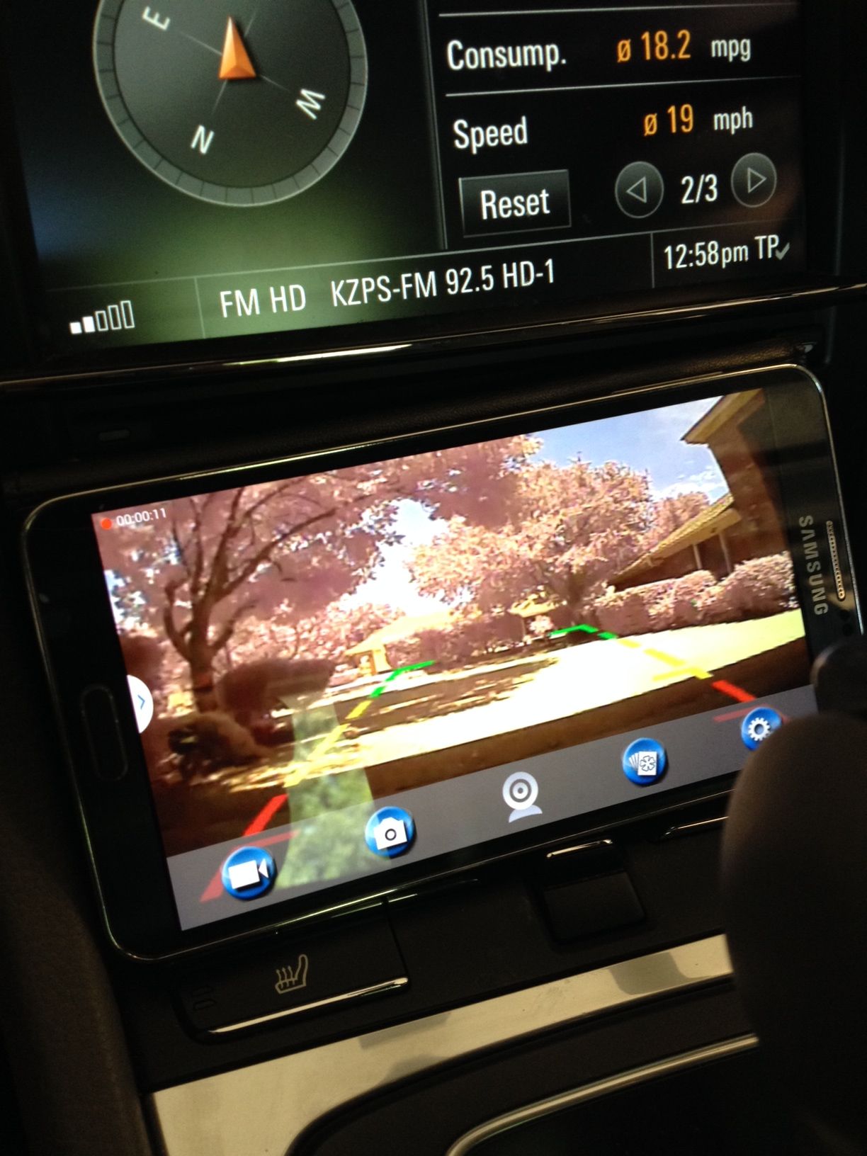

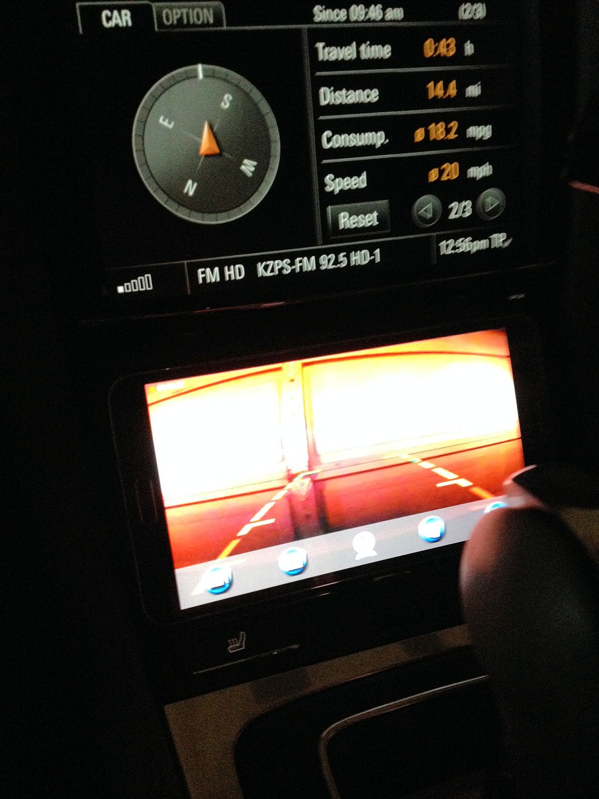

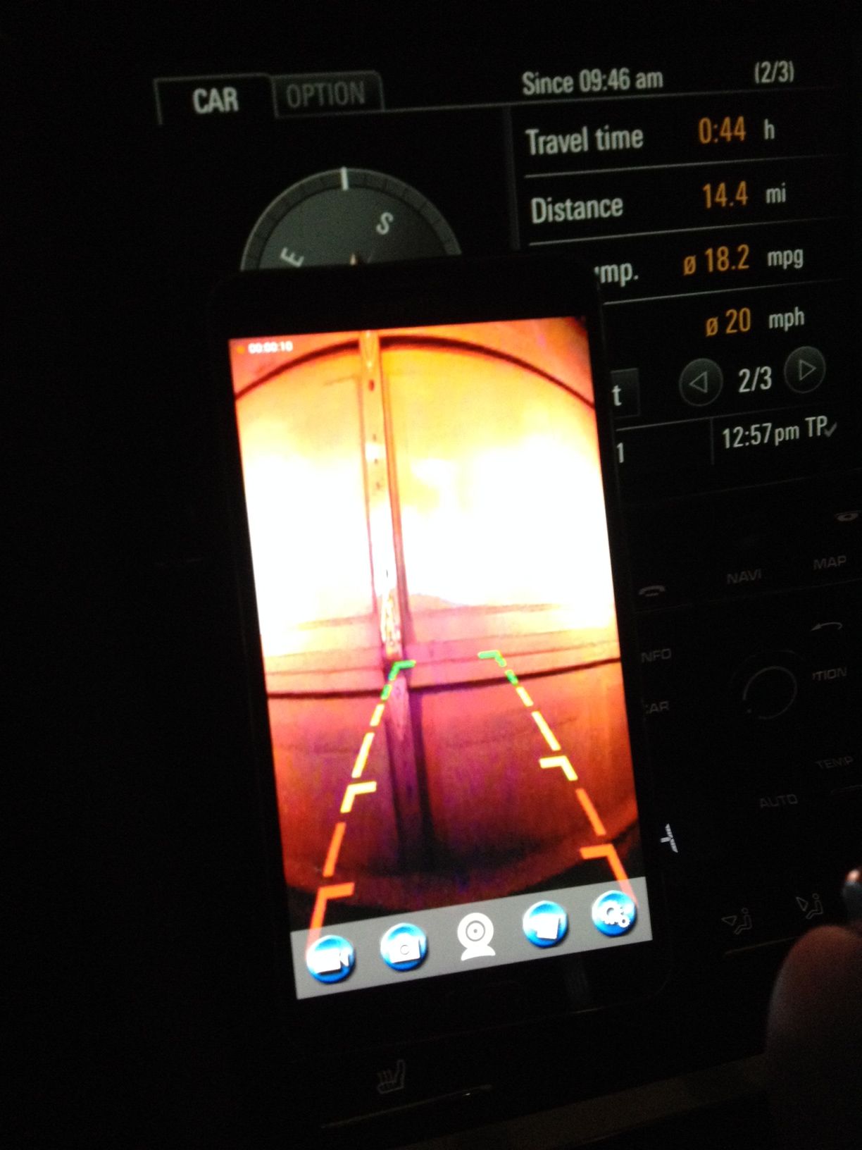

I recently purchased a wireless backup camera from TadiBrothers (http://www.tadibrothers.com/Catalog/...-Backup-Camera) that works with an Android or Iphone. It comes with an inexpensive camera so, I upgraded it with a hi-res CCD license plate camera. The system was $179.00 and the upgrade was an additional $90. I have an Android phone so my review will be based on that. Pictures of the installation and operation are provided below. The PDK lever is in reverse:
The instructions are almost useless so I’ll amend them after the review.
The good aspects of the system:
The camera is color and works very well with a clear picture and simulated distance markers. The markers tend to be misleading as to the distance from the object, but if you test it, you will soon understand how far you are from objects. The night feature works well also. Turning it on is easy as well with a single button push. You can hook it up to the rear backing lights but that’s probably not a good idea as will be evident in the shortfall section. The pictures below show the instillation plus operation close to an object and with no object behind the car. As you can see, the rotate function of the phone works with the system.
The system’s shortfall:
This is a Wi-Fi, not hardwire system so the Wi-Fi must be connected to the camera for it to work. My phone automatically scans for the closest Wi-Fi, so it will automatically connect if the power to the camera is on. Therein lies the issue of connecting it to the backup lights. It takes 7-10 seconds for the scanner to find the camera Wi-Fi. Though you can activate the camera app, you will not get a picture until the Wi-Fi is connected. I currently have it hooked to the license plate light, so I turn the light from auto to the parking light position even before I put the key in. That shortens the wait for the camera to come on. Usually it’s only a couple seconds after I start the car. I plan to have it connected up to a hot wire from the engine compartment next time the bumper comes off so I won’t have to use the light switch. There are both video and electric connectors so it should be easy to hook it up so that it can easily be disconnected when the bumper has to be taken off to work on the engine. The system can take jpg pictures and video but I'm not sure how to take advantage of that feature.
Installation amendments:
As mentioned the installation instructions are not complete.
1. The instructions fail to mention the latency issue and indicates you should hook it up to the backup lights. If you do that, no power will be provided to the camera and the Wi-Fi scanner will not find the camera for quite some time.
2. It fails to mention the black and white wires in the package which control the backup distance indicator bars. To have the indication, you simply terminate them with electrical tape. To turn the indicators off, you connect them together and then tape them.
3. Press the setting button and ensure the camera scans for the Wi-Fi.
4. The transmitter and connectors are about ½” thick. They are assuming you are putting them on the other side of the car. I used ½” spacers behind the license plate and 1 ½” stainless screws and simply taped the transmitter to the back of the license plate with Scotch strapping tape. We’ll see how that does over time.
Hope this helps anyone who like me, forgot to order the backup camera option.
