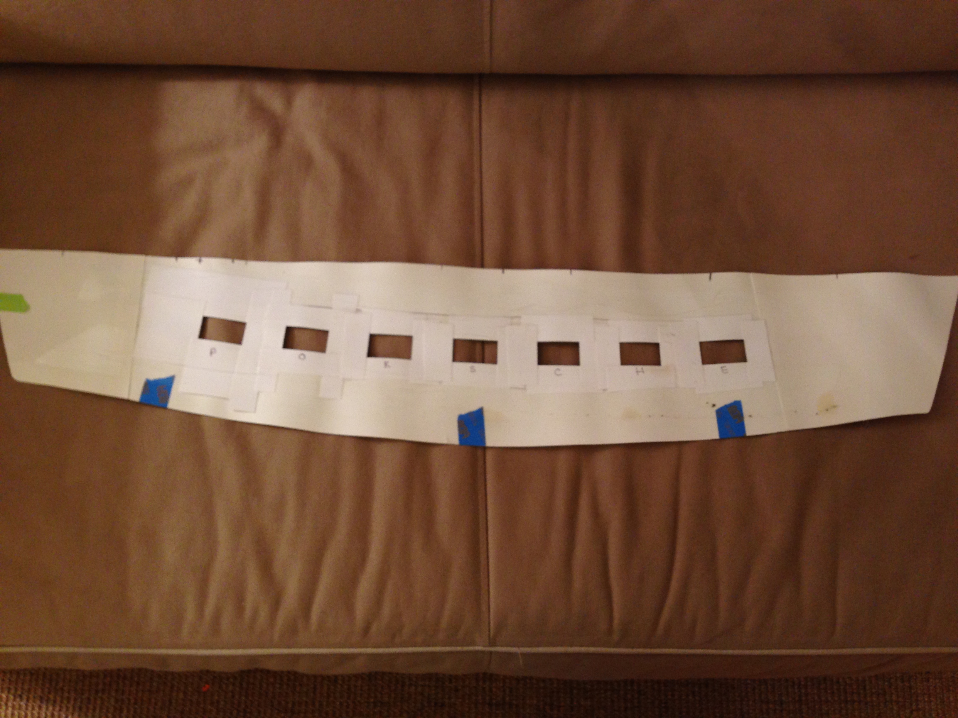

When I replaced my 981 badges to have them body color matched, I made a template before I took them off.
15 minutes with a pieces of 4x6 card, construction paper, painters tape and some scissors made the re-install perfect and easy. Since I knew exactly where the letters were going, all I had to do was make sure they were level and correctly oriented inside the template.

I can see how that technique would work. Problem with the badging on my car is since I have all the badging of the 991 (two rows, and there are ten separate objects to align), it makes the process somewhat more difficult. I really don't understand why Porsche doesn't package the badging with a paper or cardboard template.
