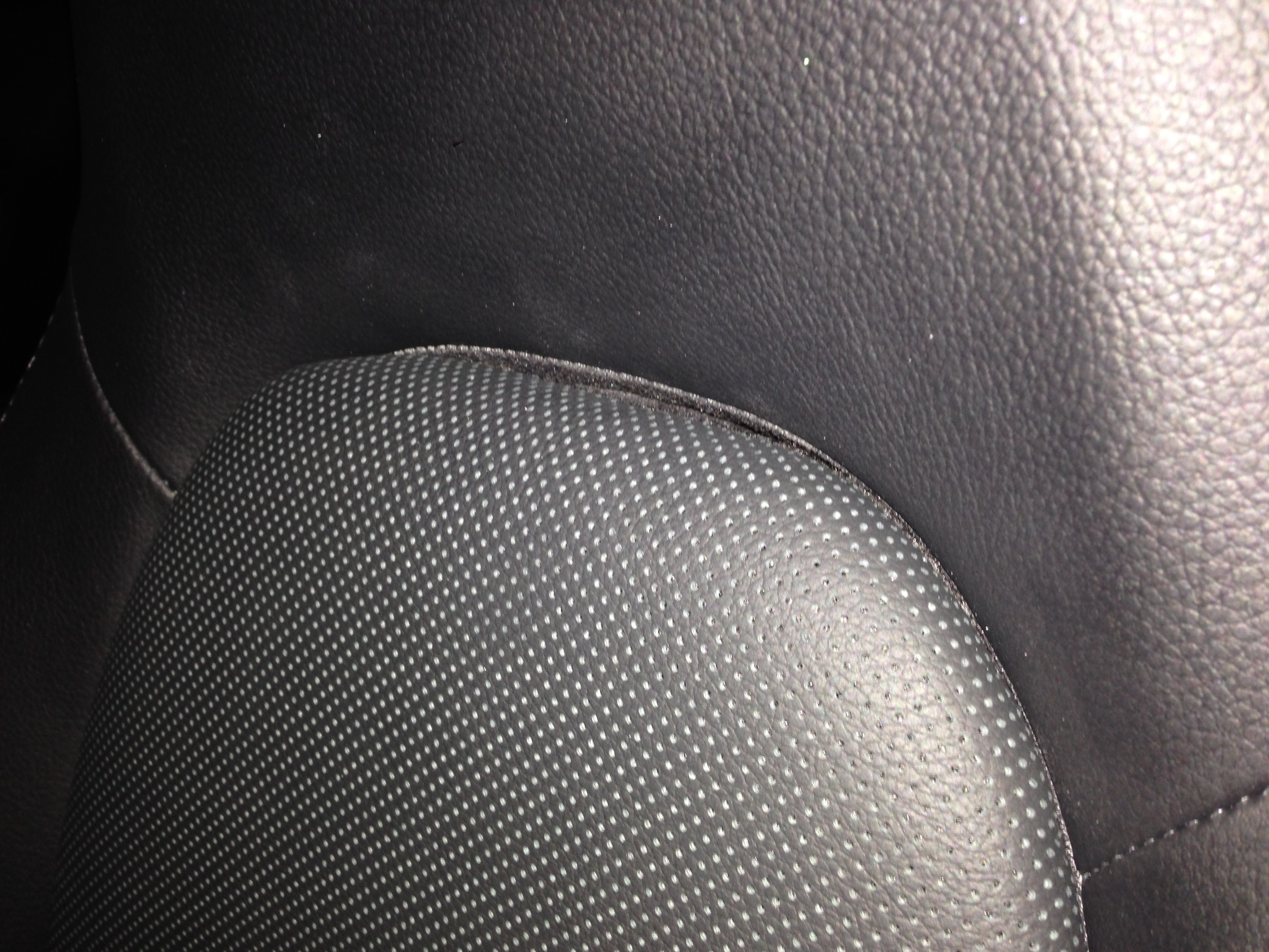

I did figure out the clicking rattle in the driver seat is coming from the lever mechanism. When I was inspecting the seat, I noticed slight separation between the seat cushion and headrest, which is a little wider than the passenger seat, see picture. Does anyone think this is within the norm, or should I try to get a new seat?

Hmm, i would definitely ask for that to be put right though i doubt they would replace the whole seat. Probably change to cushion i'd imagine.

Originally Posted by Go123
It seems after securing the most rear loose panels it did not make any difference. I think even if there was a rattle there it would be hard to appreciate anyway because of proximity to tires and engine noises.
I don't think this is an issue. Mine have a little gap as well, I believe that's how they are designed and within the norm. Perhaps you got two seats at the opposite ends of this norm, making the difference more apparent.
Also, i don't think that that's related with the seat lever rattle.

That gap does seem a bit beyond expected, but not bad and not a rattle contributor.
The sooner you ask about it the better the chance for them to address it.
You don't want them to call it wear.
Ideally find something else to take the car in for and bring this up with it.
Some cars have less gap there but that gap is hard to notice.

I intend to bring it up next week when I have them fix the rattles in the levers. It would be hard to blame it on wear considering the car is less than a year old with 2800 miles. It probably came that way, but I never noticed until I started looking closely at the seat to pinpoint the rattle.

Got the car back today, they ended up replacing the seat skeleton, evidently it was slightly deformed and hence the slight gap. The levers got lubricated and that appears to have resolved the rattle.
