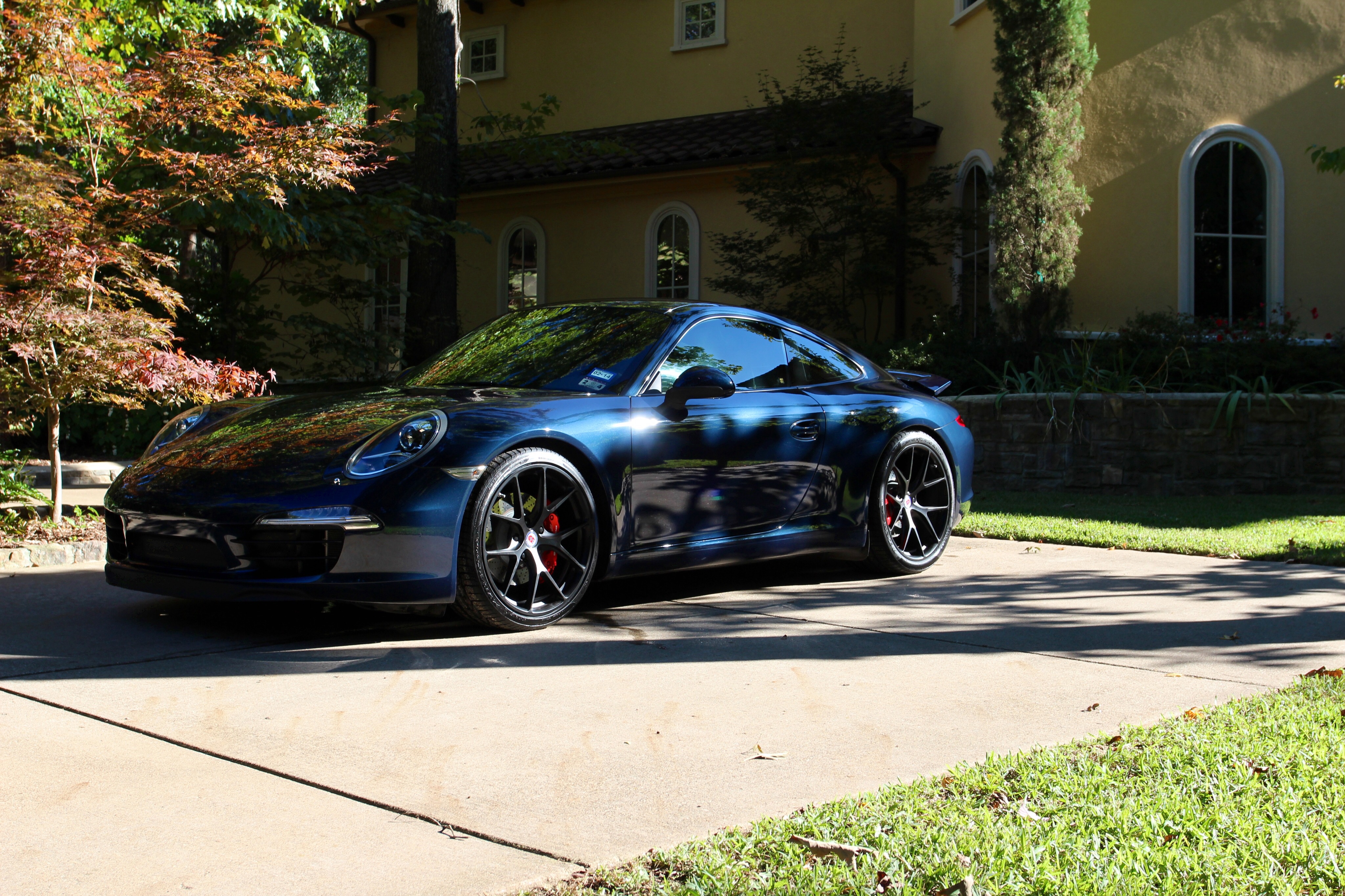

I check the TPMS daily and the pressures are not fluctuating. I don't think it's related but I upgraded my wheels to the HRE p101 and now have a 305 tire in the back. The wheels came with new Pirellis and were mounted and balanced by wheelsBoutique.
