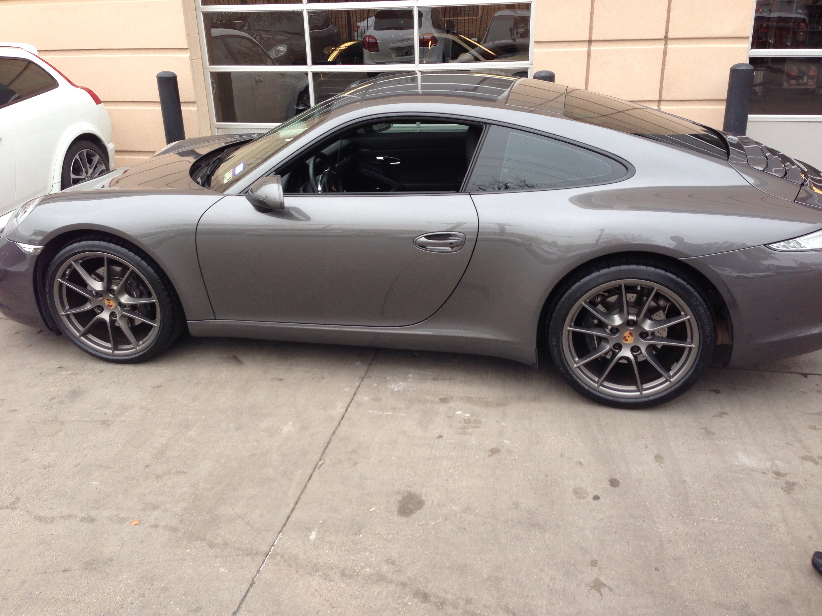

Could you post a couple profile shots straight on so we can see what you mean about the space issue and compare the profile of both tires? TIA.

Side shot

Yea I had the same reaction when the exact dimension MPSS were mounted on my techart wheels and mounted on the car, the tires are lower profile for sure. huge wheel gap, but luckily had KW V3 suspension arriving, so the gap disappear in a day. The MPSS are better tires in every way compare to stock Pzero. I put over 10k miles on them and 1 full day of open track day and there are still threads left. Better traction in wet and quieter on the road and dry grip is better over the Pzero IMO

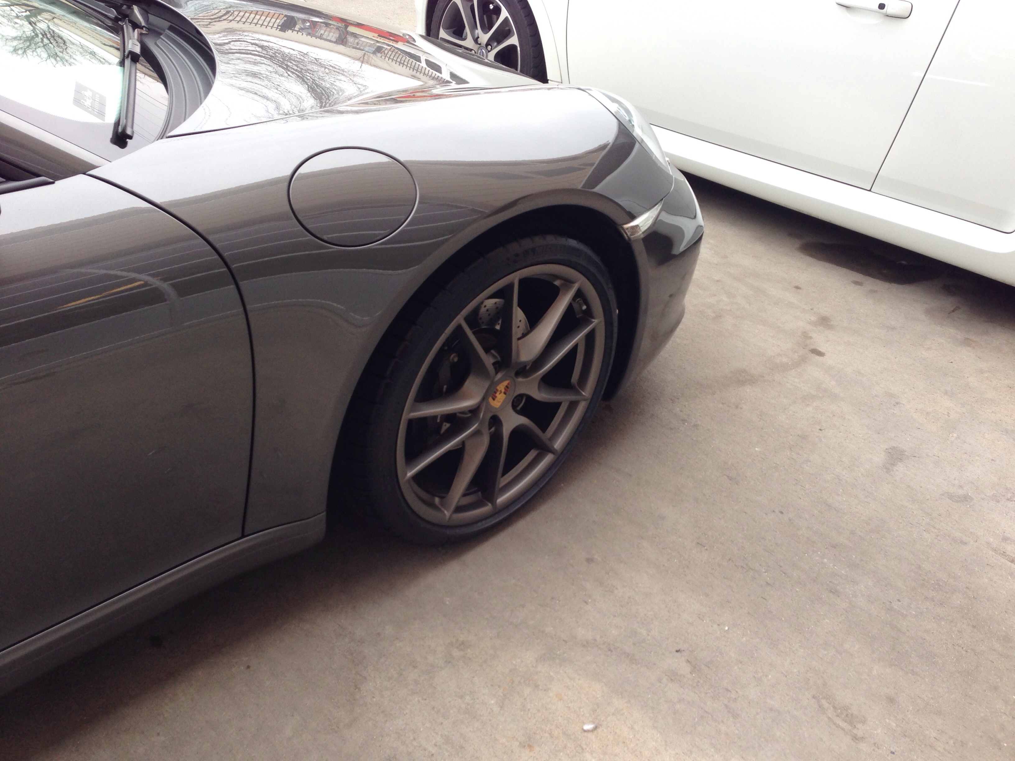

Front shot

Originally Posted by tommyboy214
I'm at Porsche. We are gonna throw either 7mm or 15mm spacers in the back and 5mm and see if it helps fill our the fenders. I'll have to live w the shoulder height.
LOL
You have a .7" wider tire, which pushes out the same as a 9mm spacer would, on the OEM tire.
Since many run 15mm spacers, on the OEM tires, a 7mm on the 305 would put you +1mm from that.
Plus you get more rubber on the inside, which nobody sees.
The wheel well gap and sidewall height is no different.
What tricks your eye is the rediculously oversized rim protection flange, on the PSS 305.
It makes the sidewall look shorter.

I'm gonna try the spacers and call it a day. It's a lease, I'm not going to do suspension too. Will see how the 15mm spacers work for rear. I like the super sports better than the p zeros so I'll have to live with it. I plan on ordering next 991 by end of summer for end of year delivery anyways.
I appreciate everyone's help here.
