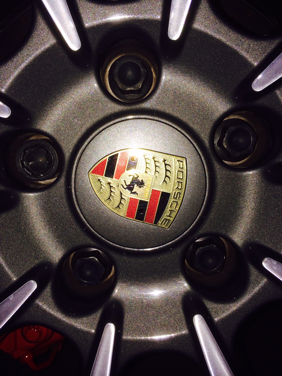

The service shop kept the wheels pretty clean (no scratches etc) but I noticed that black lug nuts have some scratches on them.. It's driving me nuts ...pic attached...am I worrying too much?????

Bad luck. I would recommend to put som black paint on the nuts.

+1. The nuts will scratch every time you loosen or tighten them. I would not go "nuts" over it, just as Ulukai suggests, just blacken them with magic marker or paint.

Sloppy air ratchet marks.
If they were careful & used hand tools, there would be no marks on the front like that.

I feel you. I'm one of those guys that brings the wheel(s) in seperately so techs never get the chance to screw up the car, let alone the lug nuts.
And I would recheck the torque as well.

Now you have an excuse to get these!
http://store.tikore.com/porsche-tita...-lug-bolt-set/
Impact guns are always going to mark a fastener surface like that, they work with a 'hammer' action to break lose the fastener and that's what you are seeing. A well-fitting socket such as a Snap-On brand put on the fastener coupled with a breaker bar and done by hand won't mar the lug faces, because that's a constant pressure movement with no hammer effect.
That's going to happen in a shop, almost no mechanics I know of are going to remove wheels by hand unless you make arrangements beforehand with them (and a small tip may be in order as well). Air tools are part of every mechanics tool box - speed up the job time considerably and time is money to them.

If if bothers you, PlastiDip'm.

Magic marker has always been my solution over who knows how many cars!
Won't be the last time, believe me.....
