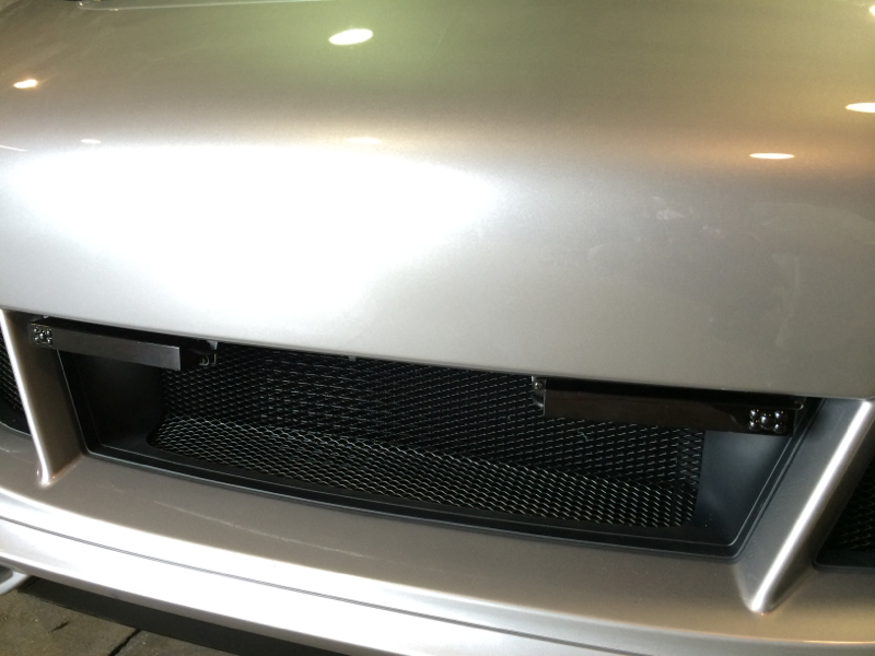

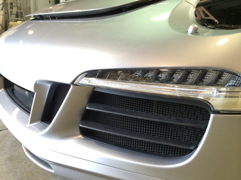

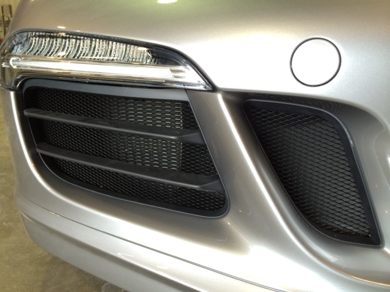

As far as mesh grills go, I ordered the ones from Rennline. Also have the mesh from custom car grills, but never used it.
Rennline bends/forms the pieces and then powder coats them afterwards. For example, on the side radiator one, it's bent up on all four sides and bowl shaped. Only by like 1/2" or so. Works better than flat pieces.
I had my body shop guy install them. The fit is perfect! They look awesome. He just had to improvise some of the fastening techniques. He figured out a few better ways to keep them in place. I think he used a bit of glue, and figured out a few ways for a cleaner install.
I would highly recommend them!
