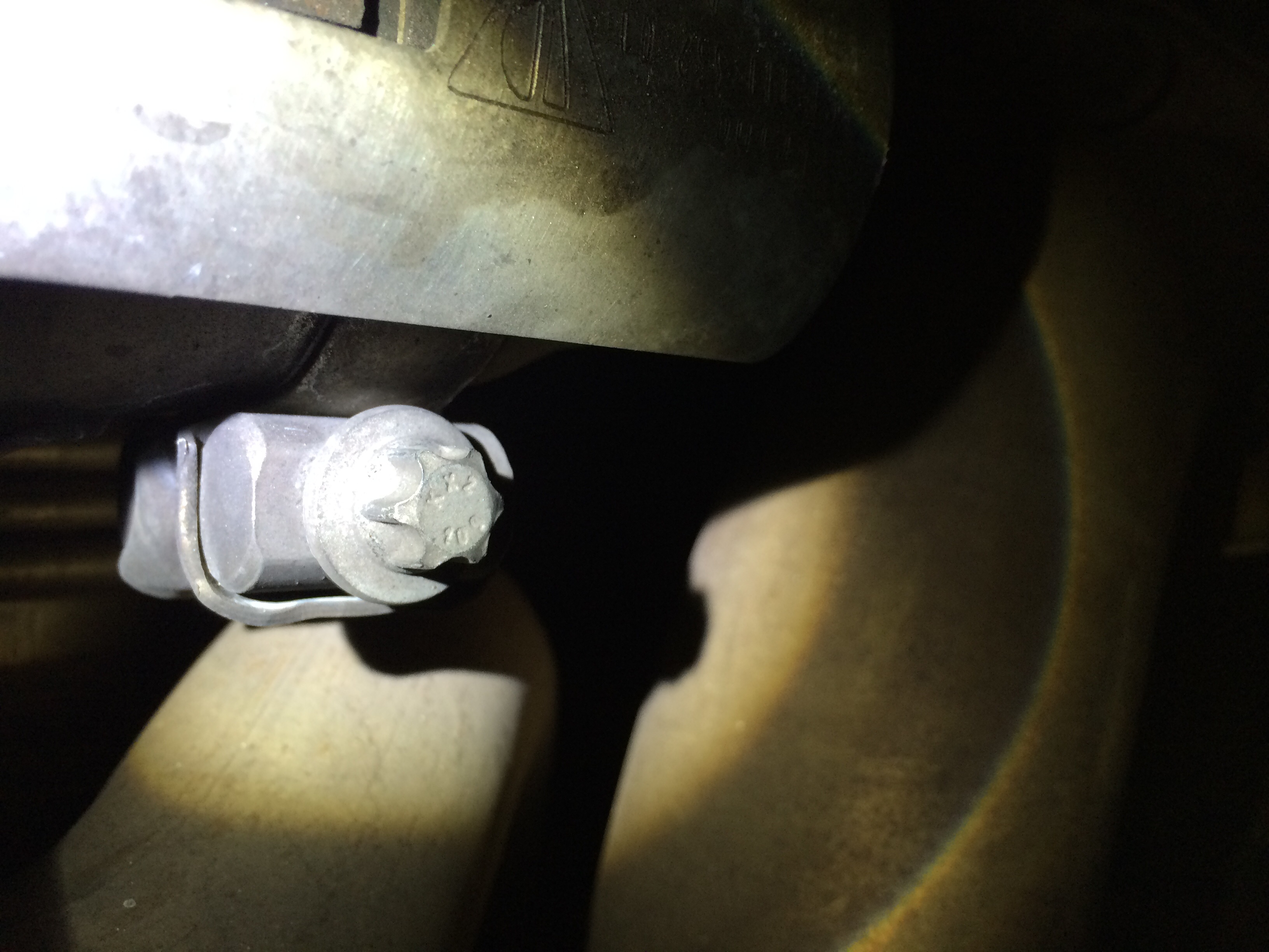

My 2012 991 C2S's tips are held together by torx head cap screw. Just like in the picture. If you look under the exhaust tisp, you will see a single torx head cap screw. Use a 10mm hexagon socket or a torx socket to loosen the screw/bolt. After that, a little bit of wiggling and the tip should come straight out.
