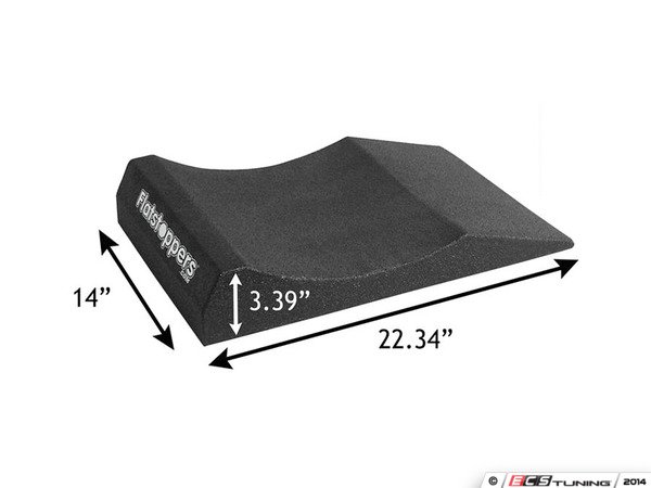

If you decide to purchase FlatStoppers, we offer them, for more information Click Here. Have you had snow yet? Lowest it's gotten so far here has been 38F. Not sure I'm ready for Winter yet.
Here is a picture that gives you a better understanding of the Dimensions of each.

How effective are these Flat Stoppers?? Have you guys tested them?
Thanks

That's getting up there. I do look forward to the upcoming snowmobile season though. We've used them on our company cars and so far they've been great.
