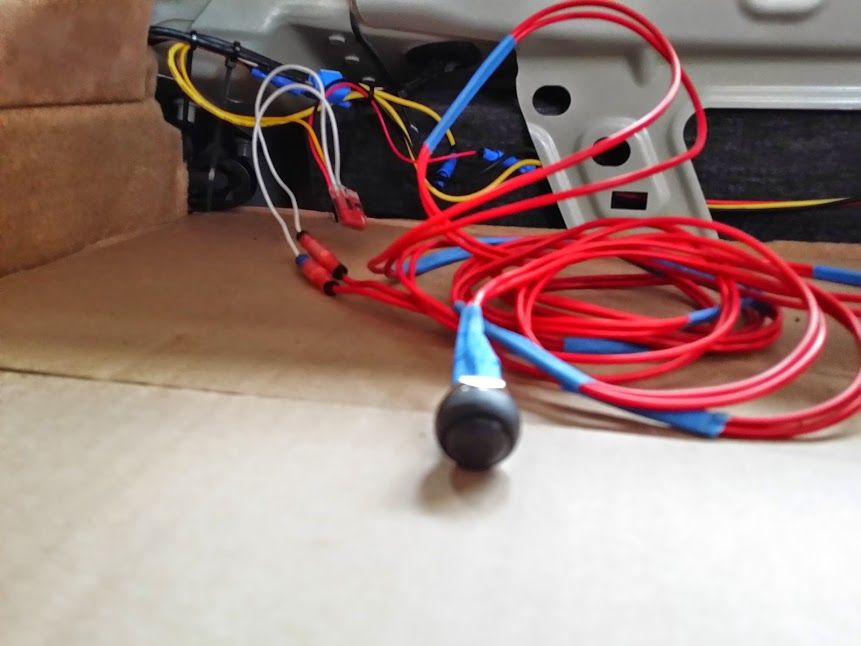

So I finally got around to this modification. One of the things I wanted was to be able to dictate how many times the brake light flashed, so I wound up with this unit. It has a very small footprint and comes with a variety of programming features including number of flashes, intensity of flashing, seconds between flashes, etc. This pic gives you an idea as to how small it is:
The wiring is the same as jawells mentions - tap into the ground wire, connect wire from the unit to the brake switch wire and brake light wire. The white wires you see are the programming wires.
I connected a momentary switch to the white wires to aid in programming the unit
Another thing I wanted to do was to have an on/off switch to the unit. There has been talk about the legality of flashers, so I connected a switch. If a cop were to stop me or I have issues during state inspection, all I have to do is flip a switch and the 3rd brake light will go back to normal (no flashes)
I was going to put the switch on the door sill by the engine cover and frunk releases, but then changed my mind. Wasn't sure how it would look, and if I made a mistake drilling the hole, would cost me over $200 to replace the sill cover. There was really no place under the dash and it seemed that the backing of the dash was metal. Did not want to drill through metal. So I just wedged the switch behind the panels on passenger seat on the driver side. Doesn't look great, but it is functional and I don't see it with the seat up.
