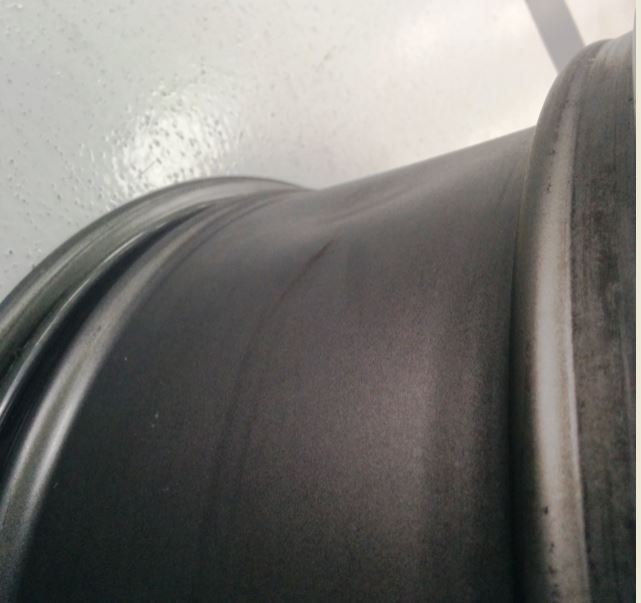

After replacing the blown front tires, the dealer could not get a shimmy to go away...until they decided to get serious and inspect both wheels. I have NO IDEA how I did this!!

Originally Posted by bccars
Kerbstones ?
Perhaps..but I never went off track, not once. This track has curbing which should not be causing this.
I have to say I am disappointed in how easy it is to do damage on track days...tires and now wheels. I will never use my stock tires/wheels on track day again. Fortunately the wheel can be repaired according to the dealer. Total damage now approaching $1000. I wonder how close was I to do more serious damage (suspension?).

I've never seen a wheel bent in that spot before.....a hit hard enough to do THAT should have blown the tire off the bead at the very least. Very odd, I wonder if the metal was weak in that area?
Or the Tech at the dealership just smacked it with a hammer, which is what it REALLY looks like.
Funny, I was thinking exactly the same thing.
Today I was off and decided to go back to the track. I am only 30 minutes away from it. Gates were opened, track was not being used. I parked my car (not the Porsche) and decided to walk the track (which I have never done before). I inspected every apex at every turn (which I was trying to nail during the track day). I was shocked of how rough, uneven, and patched up some areas were. I actually decided to walk it one more time this time taking detailed notes on how to take a curve while minimizing chance of damaging wheels. I am amazed I did not do more damage. Lesson learned...every new track I choose to race on, gets a walk with note taking prior to placing any wheels on track.
Be careful out there!!
FUNNY...My dealership in Phoenix is amazing and I trust them completely. The service department is top notch. They were actually ready to warranty the tire because of the shimmy and the fact that the road force was a bit high. When they replaced the tire with a brand new one and had the same issue, they decided to carefully inspect the wheel. Anyway, I have to say that the shimmy was never severe after the tire replacement. I bet most people would have lived with it never knowing that the wheel had been damaged.

One of the reasons I say that looks like a hammer strike is that 20 years ago I had a brand new M3 that took a heavy deer strike, the car had 600 miles on it and the deer rumpled the entire front end and even the roof. Took it to a high end body shop and the guy said the car would have been totalled if not so new, and that it needed a new roof - bu the insurance company will have him pull it and patch it. So he took out a hammer and put a giant smack in the roof and said "now it needs a new roof for sure, no patching".
True story.
