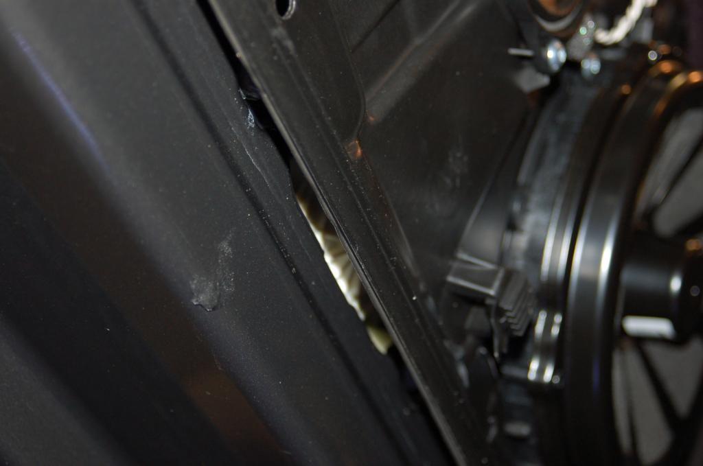

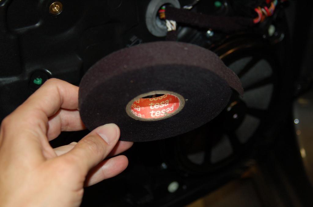

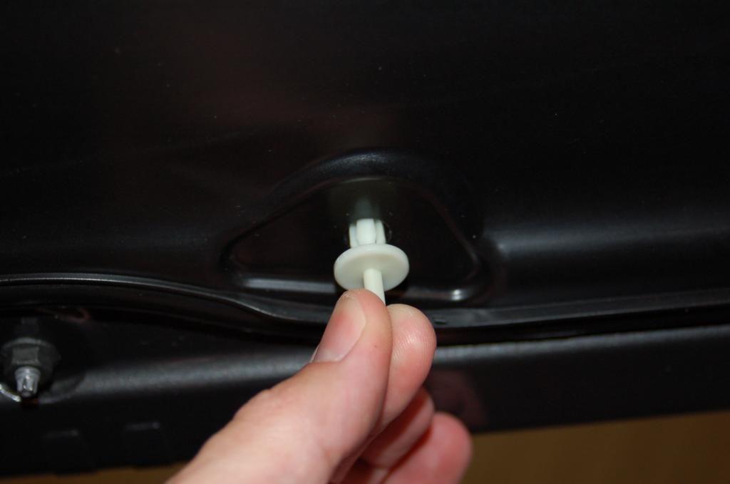

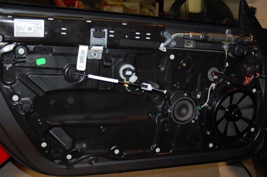

Remove your door panel. There's a DIY for a Boxster which has the same exact mechanism as the 991.http://www.planet-9.com/981-cayman-b...l-removal.html
Once you have the panel off, remove all the white push-pin clips you see in the picture above and that will loosen another panel that actually makes contact with the metal door.
Then add felt tape to the entire perimeter where the panel meets the metal.
I also wrapped the bottom edge of the door panel you removed first with some felt tape. You can't see it unless you look under the door.
