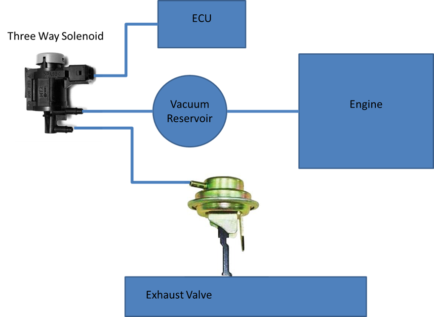

You have to understand that the two valves on all these exhausts - from stock to aftermarket to the Porsche Sport Exhaust and all software controlled and designed to open at around 3,700 RPM. The opening of the valve is physically controlled by a vacuum line which in turn is activated by the car's computer based on rpms. The diagram looks like this:
So, to keep the valves open you can either apply engine vacuum to them from idle or jam/wire them open, or you could install an inline switch to the solenoid and override the systems if you can figure out where the solenoid is located, its not easy to trace those vac lines back. I've not done it on mine because I like the car quiet under 3,700 rpm as that loud noise will drive you batty cruising on a long trip at 70 mph. But to each his own.
All the center-muffler pipe delete units, regardless of maker will be quite loud as you have removed the primary muffler from the car. The Side Mufflers that remain can't dampen it enough. Some like it loud, others not so much. I had an AWE on my car briefly and it was too loud for me, and then installed a full Tubi system which is perfect for me.
thank you for the detailed response, I'm not interested in jury-rigging things on the car (I'm sure understandably) so what is the next option? The car is not a daily driver so my intention was not to have it sound like one, I really just wanted a great sounding exhaust. If I went with a full cat back system including the side mufflers would I end up with a system that does not make use of these valves?

I emailed awe and they said customers wanting what I want just disconnect the vacuum line that closes the valve and plugging it, this leaves the valves open all the time.
The shop I purchased the exhaust through said that's fairly normal and the owner is happy to do it free of charge. If it's too loud I can always re-connect the line, we'll see how it goes.

You dont' really need to take the car in to do that, long as you don't mine a little crawling under the car. You can pull the lines off the valves in 30 seconds once you get down there. Stick a rubber plug on the valves and a screw into the vac line itself and you're in business. Ten minute job, tops.
