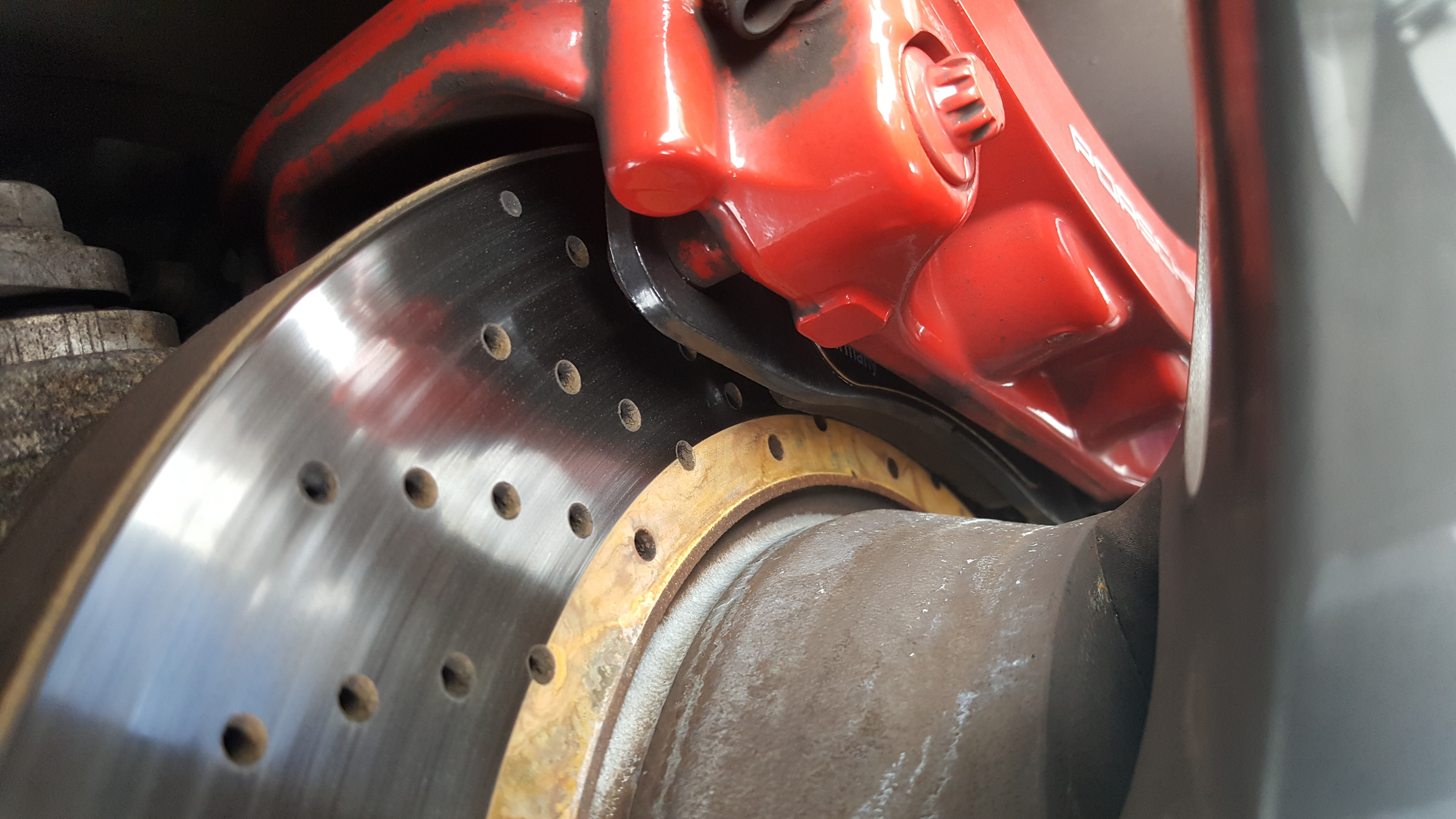

I changed my brakes last week and just noticed this. You can see the perfect rust ring where the pad never touches the rotor. Both rear brakes have the gap at the exact same distance and the caliper bolts are still seated flush with the wheel assembly. The fronts don't have the same problem.
I wonder if the Carrera rear brakes are smaller than the Carrera S, because they other wise fit perfectly?

I have a 3.4 and the pad goes all the way to the inner lip. Doesn't look right as you would expect the pads to cover as much surface area on the rotor as possible.

Yeah I just check the specs and the s/non-S rear rotors are the same dimensions. Weird. They fit perfectly otherwise.

Suncoast Porsche and Pelican parts both show the rear pads being different, are you looking at just the rotors or pads as well?
Non-S:
99135293902
https://www.suncoastparts.com/product/99135293902.html
http://www.pelicanparts.com/catalog/..._pg1.htm#item0
S:
99135294902
https://www.suncoastparts.com/product/991RBPS.html
I agree you installed rear pads that cover less radial rotor surface. The correct pads will cover the entire radial surface on the rotor's face. You can see the original pad ring imprint just above the hub in a thin darker ring of rusted surface. The thicker rust band is the area your first set of pads covered before your exchange.

Just the pads. I bought the S pads from Suncoast. Maybe I was sent boxster pads, but they're definitely wrong. My fault for not looking more carefully but everything installed so smoothly.

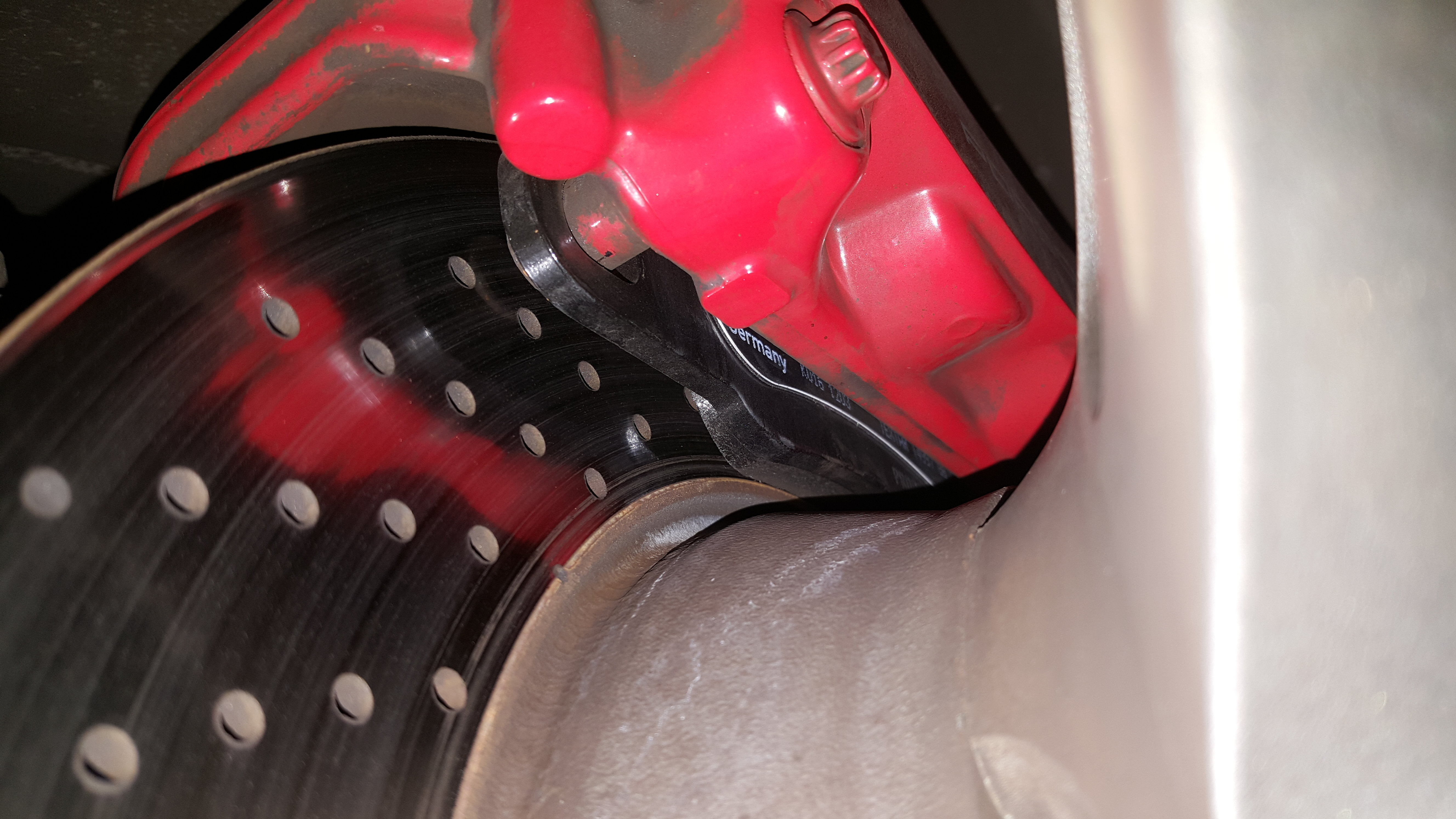

Yup wrong pads. I'm looking better now

why did you have wrong pads on?

Just pads this time around. Its a pretty easy job if you have some experience wrenching. Bought them initially from suncoast.
