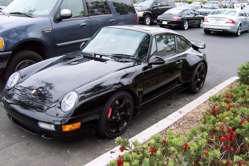

ari
- 996 wheels - no spacers
- 993 wheels with either 15 or 17mm all round
I ran 17 rear, 15 front, on PSS9's larger pic http://www.qsm.com.au/cars/993TT_2018_1024.jpg
