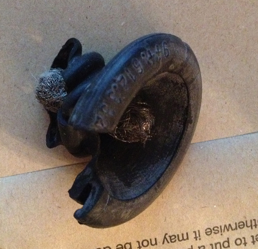

Could anyone tell me where this part goes? I had a car stereo fitted and the fitter left this part in a box with the spare parts .
944.612.332 Tried to look on the parts list and can`t seem to find where it should go.

looks like the rubber plug between the frunk and foot well. open the hood and pull the carpet back from the driver's side upper corner. look down between the gas tank and body panel, the wire from the cd changer should go through the body panel into the foot well in that area. a rubber plug should be holding the wire in place and not allowing water or air to move through the hole.
should actually be a 964 part #, so maybe someone changed it at some point.

Thank you so much for taking the time to reply. It sure gives me a good idea of what and where to look!
