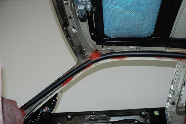

Interior (now with Integrated Roll Cage)

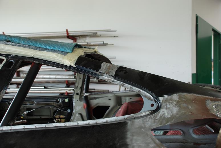

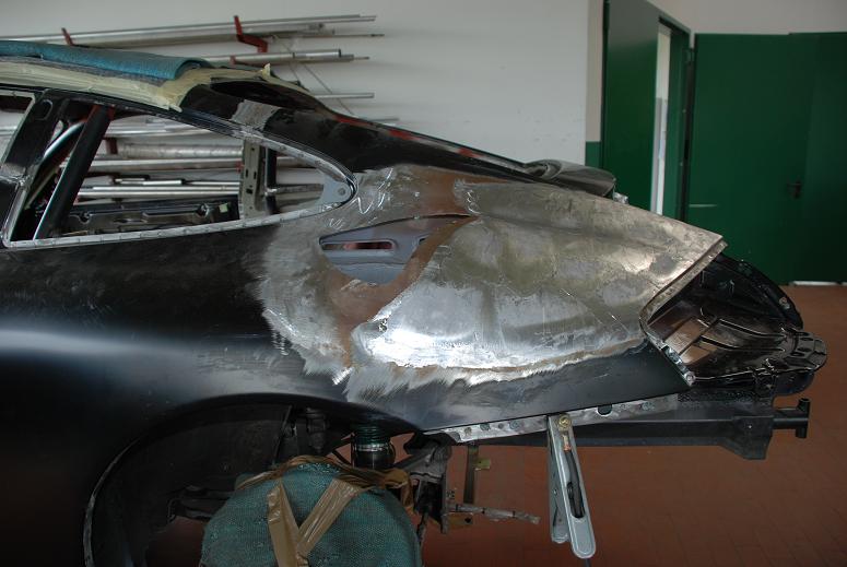

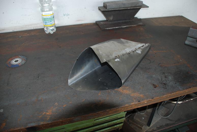

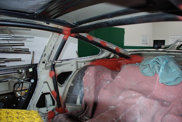

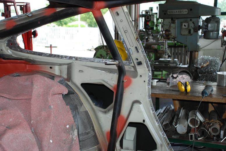

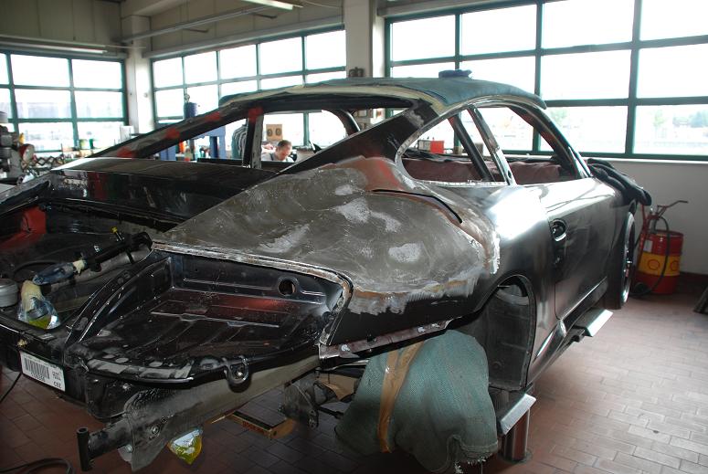

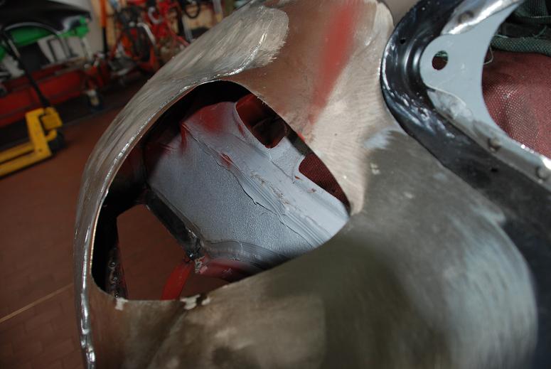

Pictures from Pfaffenhausen.
/Peter
