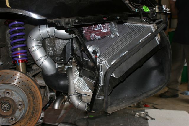

Originally Posted by John D
Don, I did some test fitting this evening and I am going to go the same route as you did - I will be reinstalling the upper shrouds with a cut out on the inside piece providing an ample opening for plenty of air to flow around the filter. Looks like this turned into a 62 hour job :-)
Is there a way you have an image of this but from the inside where you can see the filter and teh cut out you did?

contigo,
When I was running that set-up, I ended up just using the outer half of the two piece upper shroud like the picture below. I did not cut the inner piece, as I originally intended.

Pic of fenderwell cut-out:
