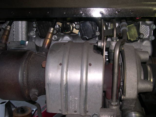

Looks involved? Looks like the exhaust or the intercoolers can be removed.

Bumper, wheel well liner, Intercooler (exhaust stays); It was tedious but I wouldn't classify it as "difficult".

Start to finish took me 4.5hrs and I spent time cleaning the intercoolers and anything else that looked like it needed cleaning.
You will need a 1/4" drive with a swivel, and approximately 12" of extension and a 10mm socket to reach up and remove the rearward nuts on the inner heat shield. The forward nuts can be accessed after pulling the intercoolers.
Everything is just R&R.

Careful with the hex bolts on the coil packs the heads can strip and removing them can be a PIA after that. Otherwise small hands and the tools mentioned help. I did not remove the heat shields, just bent them out of the way and installed the Denso Iridiums. Do a search on the gap, I remember reading the gap quoted in the manual is too wide.
