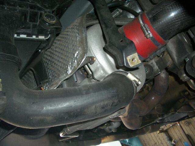

I have developed an exhaust leak coming from above the turbo on the passenger side.
I took off the bumper cover today to get a closer look.
You can visibly see exhaust carbon soot on the backside of the compressor backing plate. This is obviously coming from the Turbine or "Hot Side" of the turbo. I have had turbo cars for over 15 years and this is the first time i have had this issue.

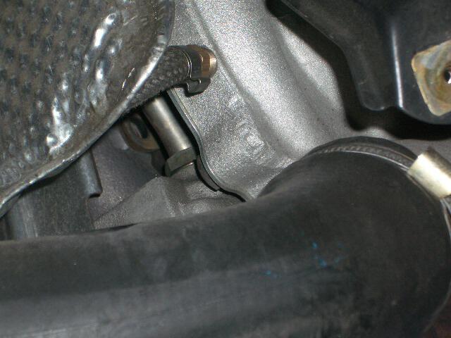

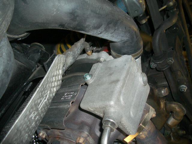

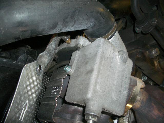

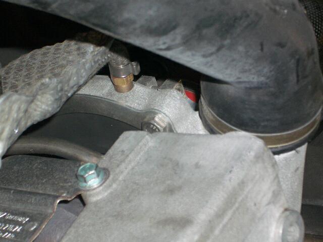

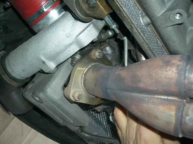

Found a Missing Turbine Housing Bolt
I Found a Missing Turbine Housing Bolt. Look closely at the first pic near the verticle oil tube for the turbo oil tank. You can make out the hole in the turbine clamp with no bolt in it.
When i started to investigate this i also found a broken "actuator rod" that controls the wategate solenoid. If you look close at the pic you will see the rod was fabricated from all thread and this is the reason it failed. The crack was at the point of the bend.I am a pro Toolmaker/Fabricator by trade and this is considered a "nono". You never use allthread when you need to make bends like this, especially on a $125k hi performance car. Looks like the bolts holding on the turbine housing were never properly torqued. Seeing that this is a brand new build with less than 2000 pampered miles i am a little bumed out!
When i found the broken actuator rod i also emailed Rob two times and got no response. Thats 4 emails with no response. Rob's definately a knowledeable guy but both these issues i just found are very unprofessional mistakes.Yeah..I guess i'm somewhat dissapointed.
Check the pics

Something you may want to check is the condition of the turbo that did not break the wastegate actuator rod. Since both compressors discharge to a common Y -pipe, the ECU will never know if one turbo isnt producing as much boost as the other one. The turbo with the broken rod probably was just idling along with an open wastegate puck while its companion was going supersonic trying to produce enough boost for both. The ECU would never know to open the wastegate to prevent an overspin on the good turbo since it most likely never the other one was slacking.....
