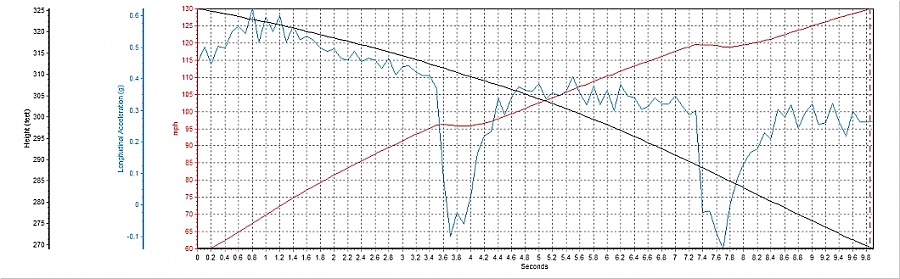

OK guys, today is 72 degrees out and I took the Turbo S out for another try. Had to have the air on because I get too hot with my black interior.
So with the air on I pulled a 60 to 130MPH in 9.7 seconds. The drift box data file do not lie. Take a look. The first file (best01.txt) depicts the 60 to 130MPH. The second file (result01.txt) look at Run 008. You will see the 60 to 130MPH at 9.7 seconds. I also attached the graph depicting the sped and time.
I now know I can get into the high 8's low 9's with the current setup. I am telling you, this Turbo S Cab is very fast.

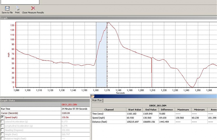

Here you go. Now I need to get me a new clutch. Look at run008. Between 1160 and 1169 seconds.

I don't see anything.
Anyway, if you could just email the .dbn file to me that would make things a lot easier. Thanks.

Well, your best run was a 9.68…but it was also on a very steep (relatively speaking) downhill slope. As you can see from the graph, it was a 56 foot drop from start to finish, or a 3.85% downhill slope. It may not seem like a lot, but it really helped your times out quite a bit.
Case in point, you had 2 other runs that were going downhill: one was a 10.13 with a 1.8% downhill slope, and another was a 10.47 with a 2.7% downhill slope.
However, one of your runs was actually going uphill. Of course, it was the slowest one of the bunch: a 10.98 on a very slight 1.6% incline.
So as you can see, even the slightest uphill slope can make a dramatic difference in your times.
Either way, I think it's awesome that you get out and run your car. She really moves well for her weight.

Scott,
Can you explain how to read the graphs. In school I wasn't very good in math...or english...or history or..

Red is speed, black is slope of pavement and blue is acceleration and the dips are shifts.
