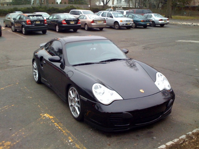

Here's mine. Gt3rs Wheels 235/30/19's fit fine up front. 315/25/19's in back
7mm spacers with 7mm longer bolts in back. Lowered on kwv3's no rubbing.
Tommy.

The 997 GT3 vs 997 GT3RS run wheels run different offsets. You will need 23mm spacers with the 997 GT3 wheels....
