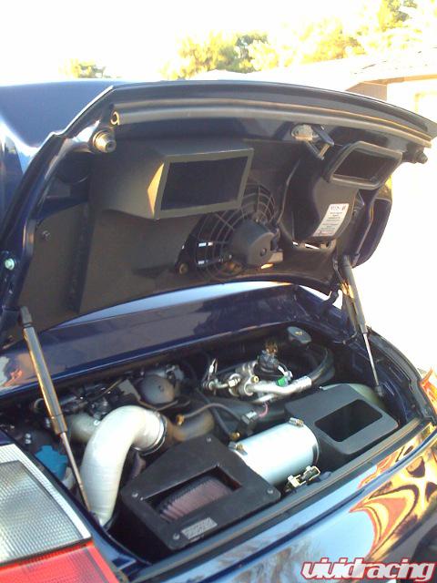

Here is the plan. I have a Vivid airbox. It is nice and what Dan promised. (alu).
I want the second snorkel as Dixie's numbers are very suggestive of more power and lower temps being available with another snorkel. To do it, I want to keep the original part "virgin" in case I screw things up completely.
My main concern is rain. I have been told that it is not a big deal and if you look at the unit Fabspeed sells, I wonder if I am just being a silly person. Dixie had a trough (sp?) made up into his unit(s) and I plan to do the same thing.

Thanks. I plan to cut the plastic the vflow seals against directly above it...so in essence you could "see" the filter from the decklid grill with ease after I am done....so without the second snorkel I am not worried at all about rain. With it, I am a bit concerned. I have the pictured unit* in hand and want to make it monsoon proof with a snorkel as in the picture. Rain water is now "right over" the filter and no longer on the far right side. I would never be able to drive around with the fabspeed on my car because I'd be worried about water all the time...just me. I am sure it is ok, but the design and I are just not psychologically compatible.
I'll put a trough in with a drilled hole and go from there. I suppose I could always carry two box covers with me and if a HUGE storm came up I could stop and either wait it out or switch. Dan's design is very flexible with tinkering.

The part is actually fiberglass of some sort, and a real mess to work with. Go pick up a salvage one and save yourself some $ - you won't want to change it back (unless you want to keep one for cores when you start making them for everyone).
The GT2 decklid is completely different, as is the 997TT/GT2.
Rain is not a big deal, I don't care what anyone says. It rains here all the time, and a few drops even if they get in won't hydrolock your motor. No need to take any crazy precautions.
I suggest using the 997TT 2nd snorkel as well since the fit is just about perfect, and TAKE YOUR TIME (I know you will).
