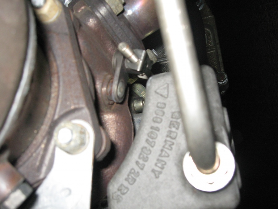

Kevin, No not an X50. I had the k16/24 hybrids.
Greg, remove the retaining clip holding the two nut in place on the threaded wastegate rod. Mark the nut with a dab of paint for reference. Move the nuts one full turn forward (toward the front of the car), tighten them against each other and replace the clip. Try it and see if you have more boost. I am not sure how many turns are required, but I would not go more than 2-3. Here is a close-up of the nuts and retaining clip:
