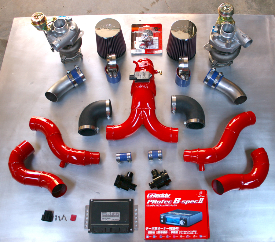

Protomotive Shipped my K24/20g's today

Mark, As far as 20gs, what upgrades need to be done beyond what is typically done with the 18G's? To get setup right? Who is clipping the turbine wheels and a doing 20gs properly in your opinion?

you need basically waht a proto set up is... 60 lbs injectors, 2nd pump hooked up in the back... way better intercooler, bigger Y pipe. maf and maf housing...
a really good clutch.... 20gs... ported, polished, etc... 12 psi spring... possible the proto intake system or at least the FVd/evoms one... free flowing exhasut.... NOT 200 cel cats...lol
this is waht I have as well except I have the 76 mm TB and splitter and my fuel system is different... this set up also will work with GT3076rs but requires way more work and money...

Protomotive blow through intake done and 20g's going on this week hehehe

tim congrats bro you took my advice .. your car will be scary now .... i cant even immagine...
