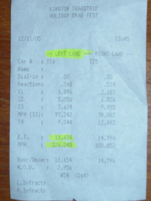

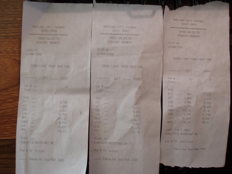

Wow...those certainly are some slow traps. You guys are running 7-8 mph slower than what faster drivers are getting. Here’s some comparisons for you:
Stock 996TT:
Titan Racing ran a 11.79 @ 116.3 in a bone stock 996TT the other day. https://www.6speedonline.com/forums/...-post1088.html
Motor Trend ran a 11.9 @ 116.1 in Nov, 2000 in a bone stock 996TT.
Car and Driver ran a 12.3 @ 116 in a bone stock 996TT in Sept, 2000.
Motor Trend ran a 12.2 @ 116 in a stock 996TT CAB (heavier than a coupe): http://www.caranddriver.com/reviews/...take_road_test
Stock 996TT X50/S:
Motor Trend ran a 11.9 @ 119.9 in a stock X50: http://www.motortrend.com/roadtests/suv/163_0310_porsche_cayenne_turbo_911_x50/index.html
Modded/Bolt-on cars:
My car at EVOMS Stage 2. At the time it was full weight, AWD, and only had an intake, exhaust (w/100 cell cats) and a tune. I was only at the 575 crank HP level yet I ran 11.65 @ 126…which is the same as your GIAC 690 997TT with 120 more HP. This was on the stock K16s!
Jimmer23 here on the forum ran a 11.59 @ 124 with only exhaust w/100 cell cats, 1 BAR wastegate springs, GIAC tune, flywheel and clutch.. Around 550 crank HP. https://www.6speedonline.com/forums/1840851-post35.html. Also on stock K16s!
Dmaffo ran 10.8s-10.9s @ 133-135, AWD, full weight with only Proto K24/18Gs, 5bar FPR, B6 intercoolers, drop in filter, and a tune. Another 650 crank HP Proto car. https://www.6speedonline.com/forums/...u-go-guys.html
My car at only 70 lbs under full weight (with RWD conversion) with K24/18Gs, exhaust, Proto intercoolers, fuel system and tune went 10.6x @ 135-136 at 1.3 BAR on 103 octane. I was making around 675 crank HP at the time.
Below are my timeslips of my car at the 575 crank HP level and the 675 crank HP level. As soon as either Putfile come back up (it’s currently down) or I get them uploaded to Streetfire, I’ll post the links to the vids of both runs for you.
There is no way a 500hp to the wheels turbo can hit 130mph unless a ton of weight is stripped out.
I really don’t know what else to tell you, other than it seems that a lot of people with less power are running significantly faster times than you and your friends are with "more" power.
