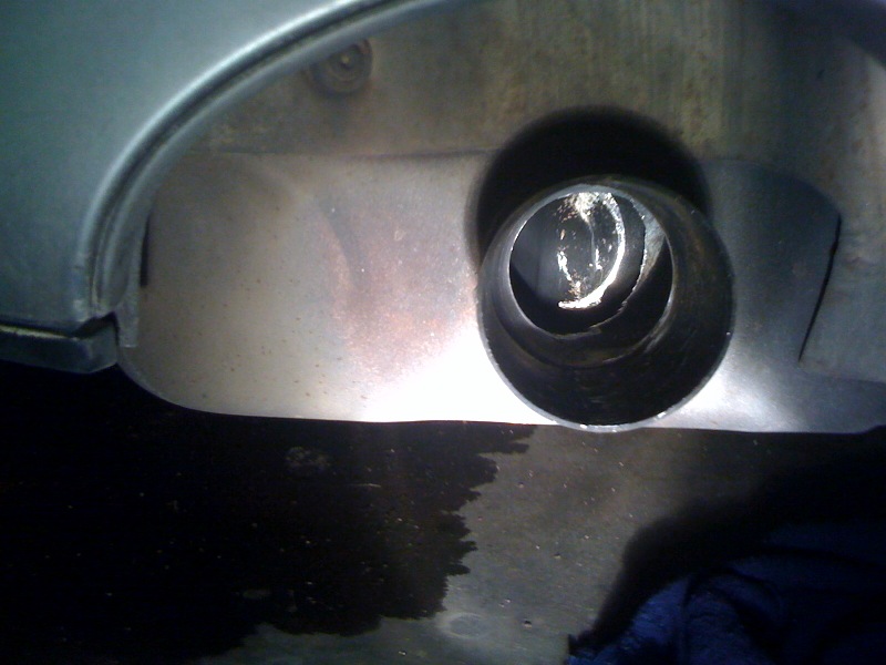

Look at both tips and notice where the exhaust pipe is at inside it. I would do 1 side at a time if for no other reason you have the other tip to look at to make sure you get the 1st one back on in the right spot. You will want to put it back in the same place. Take off you exhaust tip w/ the 13mm socket/ratchet. These bolts are most likely rusted so spray them real good w/ the penetrating lubricant. Lefty loosie, righty tighty. You are upside down so it is backwards. If your not sure just apply some pressure 1 direction then the other to see if it gives. Be careful, these bolts get rusted if the car is drove much at all and you will twist the head off and need to get an easy out kit and a new bolt.
Use the rubber mallet to help remove the tip. You need to work it off and on by twisting it by hand and hitting it w/ the mallet.

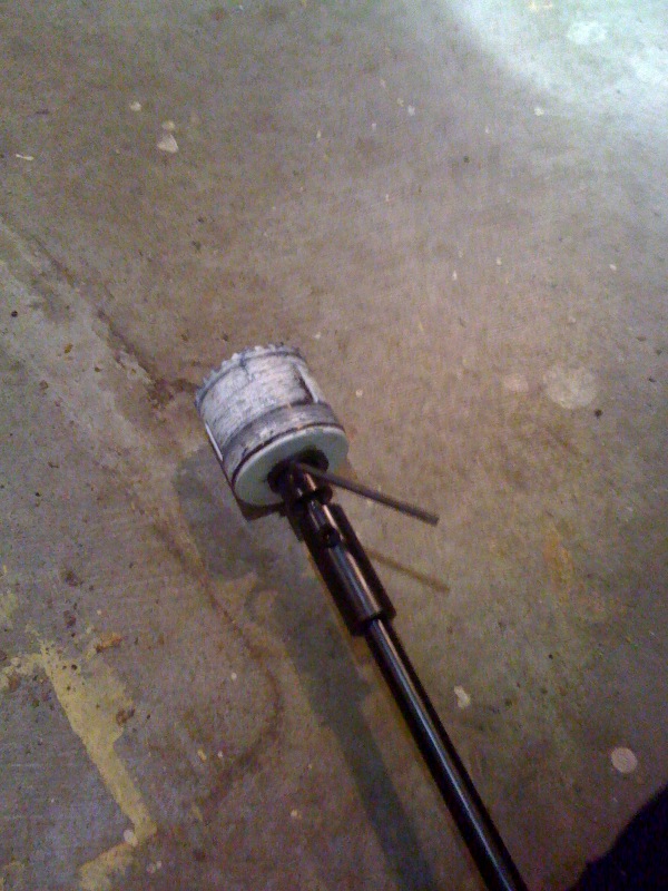

( Pic #1 ) Get your drill bit extension and hole saw locked into the drill.

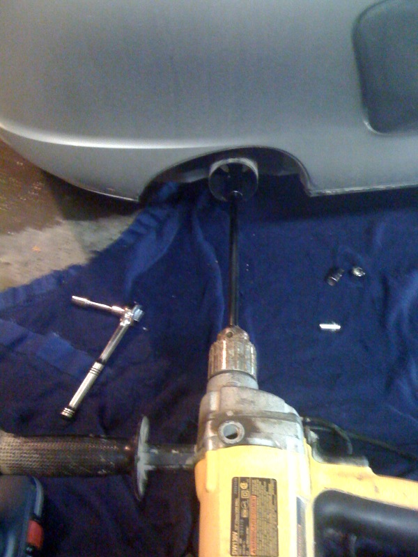

(Pic #2, #3 ) Start drilling. Every now and then ( for me it was about 20 seconds at a time ) pull the drill out and used the flash light to look into the exhaust to see progress.

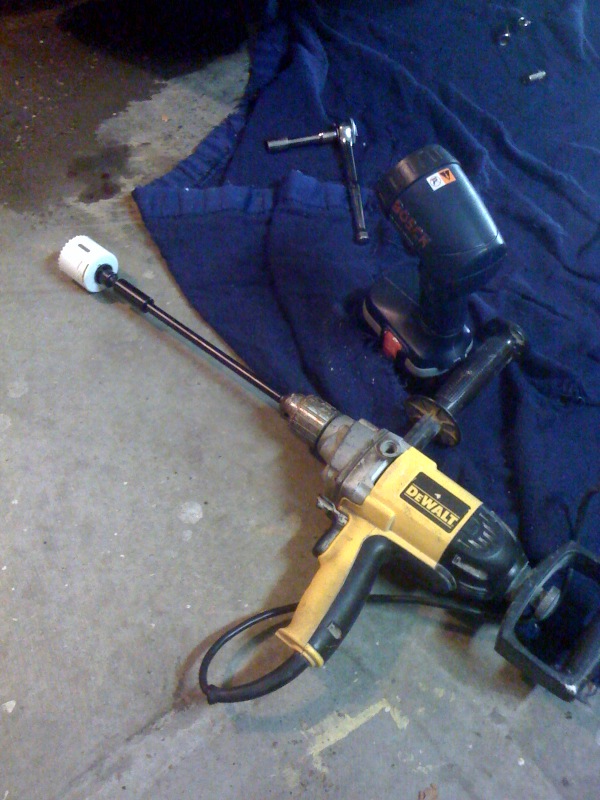

( Pic #4 ) When you see the drill bit has made a hole stop and take the drill bit out so you don’t punch through the back wall of the outer shell of the exhaust.

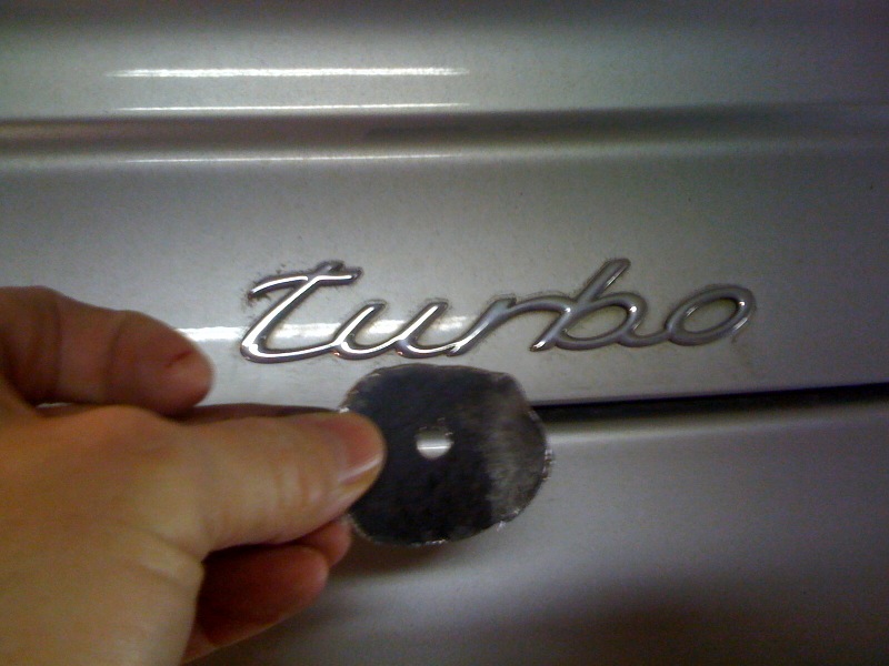

( Pic #5 ) Here is where the Allen wrench goes to get the drill bit out of hole saw.

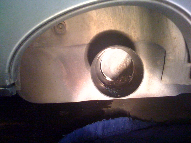

( Pic #6 ) You can see where I still got to the back outer wall of the exhaust. If the drill bit is still in you are likely to punch a hole in it that will have to be welded up. When you get close to having the hole completed just let up on the pressure trying to push it through.
