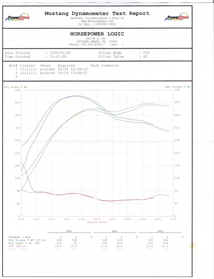

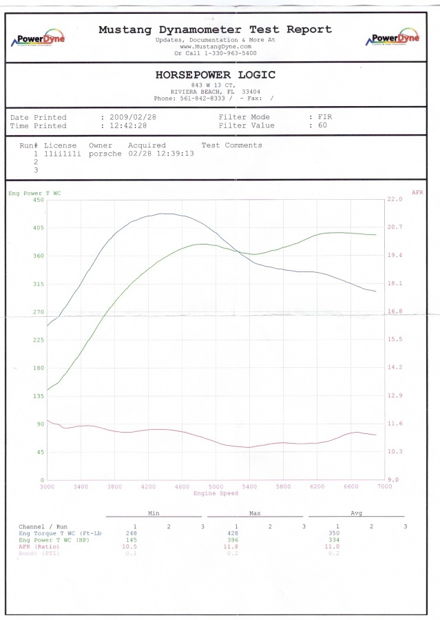

I went to the Dyno the other day and figured I'd post the results...
2002 Porsche TT Stock K16 Turbo's with 50,000 miles
K&N filter
AWE 3" Straight Pipes
20" Iforged wheels
Stock Diverter valves (I need to put my new ones on)
401HP and 430trq
(Second Dyno has air/fuel ratio chart) (First dyno shows comparison of heatsoak 1st run and 4th run without much air)

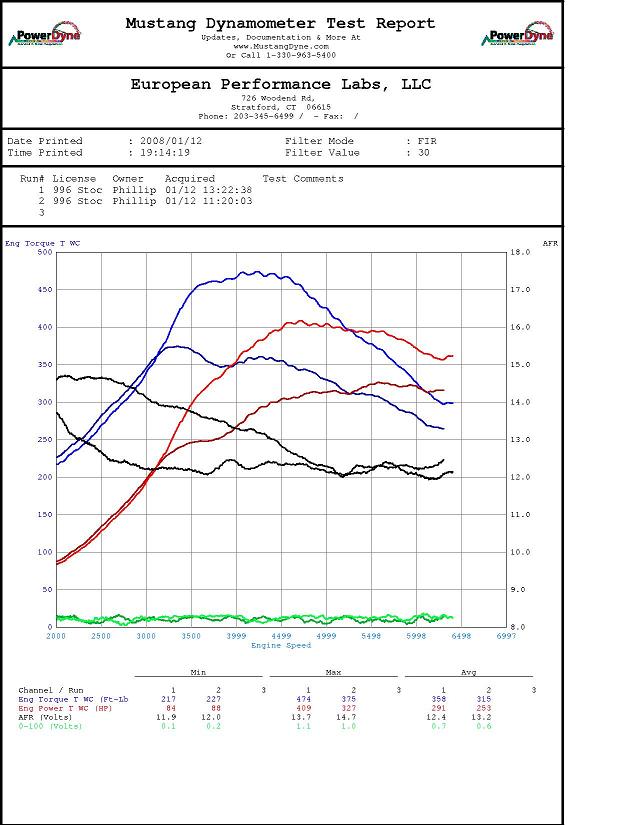

Tony Posted a graph of EPL's stock flash at 400HP and ...... The filters used were a little bit different on my dyno run which may contribute a very little Horsepower to my car had we used the same as EPL's dyno but not that much different. His dyno also showed right around 12:1 Air Fuel ratio across the board. Mine showed 10.5-11.5 which will definitely contribute somewhat to less horsepower.
TONY'S STOCK K16 Flash
I'm very happy with how the car runs but kind of confused how much horsepower my wheels are taking away and why the air/fuel is that rich?
If anything the straight pipes should cause the car to run leaner then a restrictive stock exhaust.... I've got 20" Iforged wheels on which are about .5 in bigger up front and about an inch bigger in the back, these may take a little power away but probably not too much.
In the end I like the tune and hoping that when I change my straight pipes to regular muffler exhaust it doesn't run RICHER and loses horsepower too much.
The first dyno run was the higher number, the second dyno run was just a little lower peak numbers but lost some in the midrange as the coolant temperature was SUPER HOT around 200 maybe as it was heatsoaked from sitting with no airflow.
Any and all opinions are welcomed.

What was the fan set up like? Did they have fans in the front of the car as well as the IC's? 3rd or 4th gear test?
BTW this is well over 500 crank hps . Congrats!
Get rid of those dubs son! Results look great, I'd put a wideband in the car to double check, I noticed similar on our dyno 02 using 2 differnet 02's, logged it against my Innovate LM-1 and the innovate was spot on.
It was a innovative wideband that was very very accurate as I watched it on other cars that day and I know when the innovative wideband goes bad....
It definitely won't read 20.9 when you let off the throttle, but this one did.
It will usually start reading off from that reading like maybe 20.7, 20.6, etc...eventually throw a heater error code in my experience.
I definitely believe the wideband was spot on as it was a innovative lm-1 with a aux output to the dyno so it could read it on the graph. It was put directly in the left side tailpipe.
No fans on front of car. Only little fans in rear intercooler vents as I think thats why it got hot so quick. The power doesn't fall off it's just in the midrange that I think it might pick up a little. 3rd gear only pulls. I dont' have a durametric so I can log it but if someone wants to lend one I'll log the car till the cows come home...

I recently tuned off site on a dyno in MN on a dyno with almost no fans. Cars were loosing 20-30 hps even on a cold pulls because there wasnt enough air movement..
We ended up going out to a local rent-a-center and renting carpet fans.... The set up below still isnt enough.
So if I have this exact setup but with the upgrade DV's and a full 100cell exhaust (gemballa/remus), what you think the approximate HP my 996TT is putting to the wheels?
Also a shout out to Tony for his flash, the car is so much more drivable and the added 100hp is nice too!

So I guess the conclusion is that the power looks good? Maybe a little to be had from the wheels but not a whole lot and maybe a little on the smooth filter on the dyno but not much there either....If I get the itch I'm going bigger turbo's I suppose.

I suggest a pesticide/bug sprayer from Home Depot. Fill with water and spray on the intercoolers every coupe of runs. I noticed that when tuning my personal car, this made a huge difference in power(obviously), but also allowed me to perform back to back runs to simulate heat soak, then cool it all down and test it again. Coupled with a fan or two on each IC, it can make your dyno session a much more pleasant(and expedient) one. Although not always feasible, removal of the rear bumper also helps.

These cars NEED fans on the front and on the intercoolers. Its not worth paying to dyno the car if there isnt enough of a fan set up.
