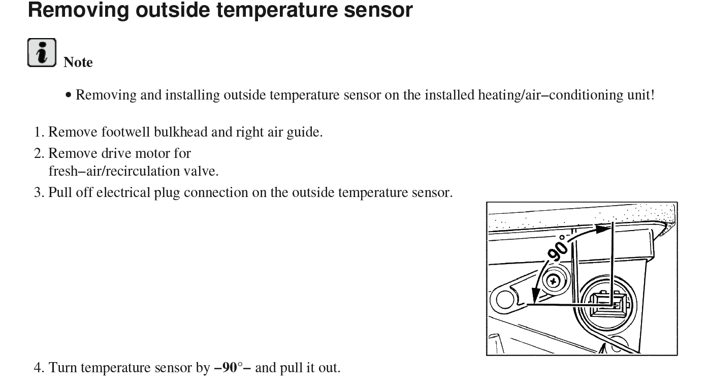

As the title states... My outside temp senso is giving me a error code. Car has a bit over 50K on it and I am going to just replace the sensor. Has anyone done this themselves and how hard was it? Also how much is the part?

The part# is 996 641 142 00 and it is $17.25 aprox.... Very easy to replace.... Of course you should check the wires first and clean the plug...
