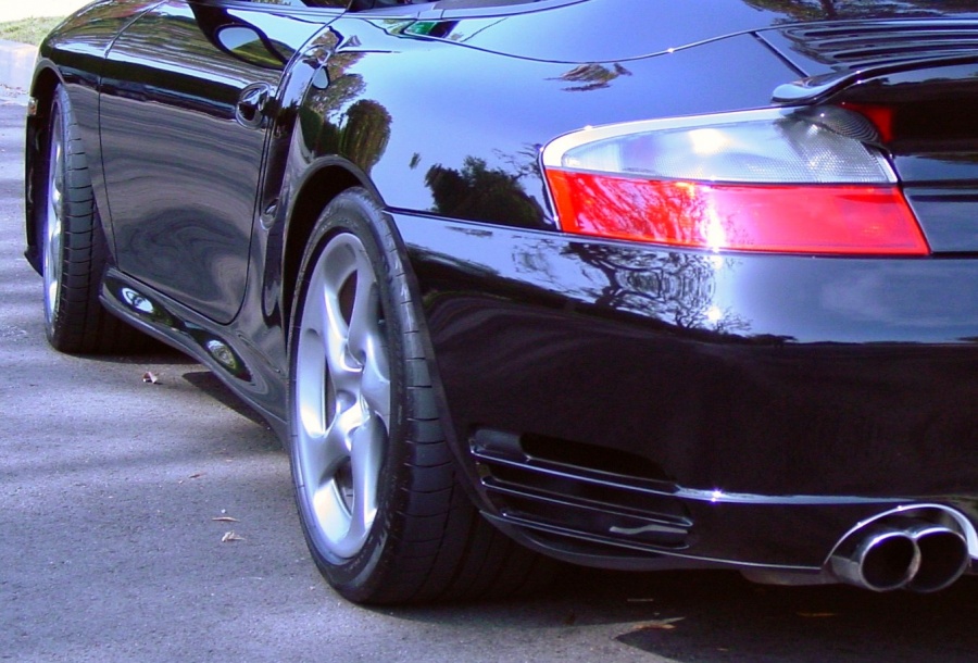

315/30 certainly fit on stock wheels...what I have been running for past few years. However, I am not sure about the spacers you have....I do not have spacers on mine, and at GT3 height with slight neg camber. See pic
