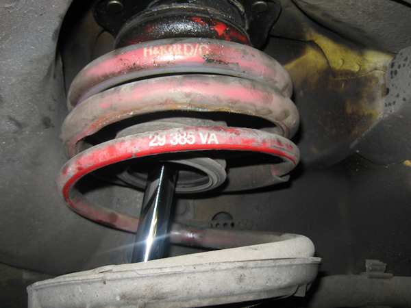

Don’t do the H&R springs. See photos, what happens after 25K miles. Sag followed by clicking noise as coils rub against each other. Also you will destroy upper mounting cups. Use search you will find my thread on it. Also, because you are on OEM shocks, the springs will compress them which will make you car floaty at speed. Get PSS 10's and don't listen to people saying that lowering with H&R springs = great handling. Nobody who understands handling and racing would change just springs - it's really dim-witted. Previous owner of my car did it and now I've had to fix it. Car is now night and day. ;-).
