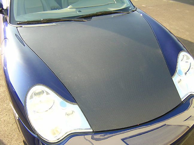

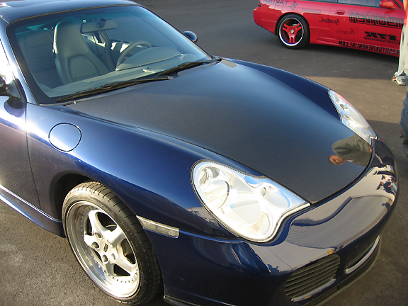

Higuys last friday as some of you may know , me and peter (cruves4s) went to check out the carbon fiber hood that was mentioned on a previous post..
here a re the pics of the install, i believe that it is a pretty good fit and the quality is good for the price..
OK I JUST WANT to remind you that the hood that I test fitted was a trial hood and not the actual hood that would be sold to us.. the quality will b emuch better than the one that was fitted on my car..
here's a pic of it on my car with teh hood latch on.( me and pete wern't there coz we were eating lol)

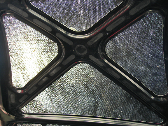

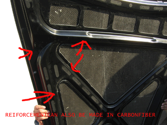

here is a pic of the underside
the under side is actual carbonfiber and not fiberglass with a layer of cf on top, as you notice this is a mockup hood and not the actual production one, also as an option we can have the reinforcement made out of carbon fiber too..

what was their reasoning for not rolling the edges again? Doesn't look to good w/ them just cut like that. Fitment looks decent, but that's typical w/ the piece they bring in for test fitting

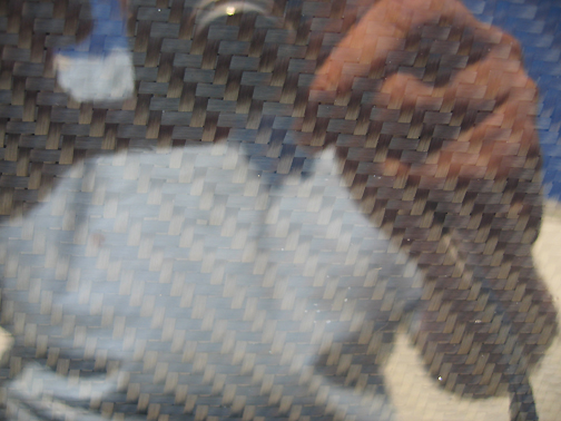

Get a closeup of the weaves. What is the making process?

hre's apic of the underside showing that it is just cf and not fiberglass with cf..
i believe the hood is less than 20lbs..

the reason for not rollling it is bec. it didint looked good with it rolled , i saw th efitment with the cut edge and it did actual look good in my honest opinion

here's apic of the weave upclose...

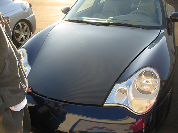

here's a pic peter being meticolous about the hood..
he more **** than me, that's why he's dooing the inspection

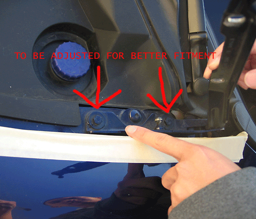

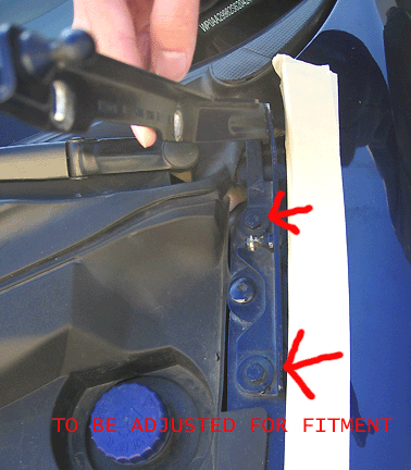

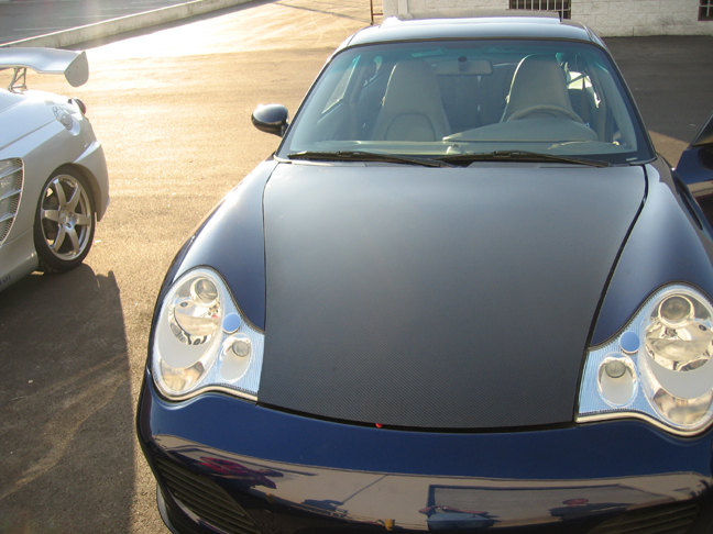

here is a pic of the hood again installed on my car but without the hood latch on notice the gap on the front , and if u see the gap is bigger onthe right side compared to the left, the left was too close while the right has a big gap, what needs to be dont o fix the gap is to do an adjustment on the hood hindges by the windshield.
alot of people make a mistake and assume that hoods fit perfectly and without adjustments... you actually have to do soem adjustments to make the hoods fit perfectly..

these are what needed to be adjusted for better fitment
notice peter's nice clean finger

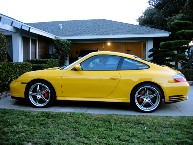

Here's a pic of Peter's car since your probably tired of looking at carbon fiber and my car...
look at pete's nice ssr gt's speed yellow c4s makes me want to get a yellow turbo...
