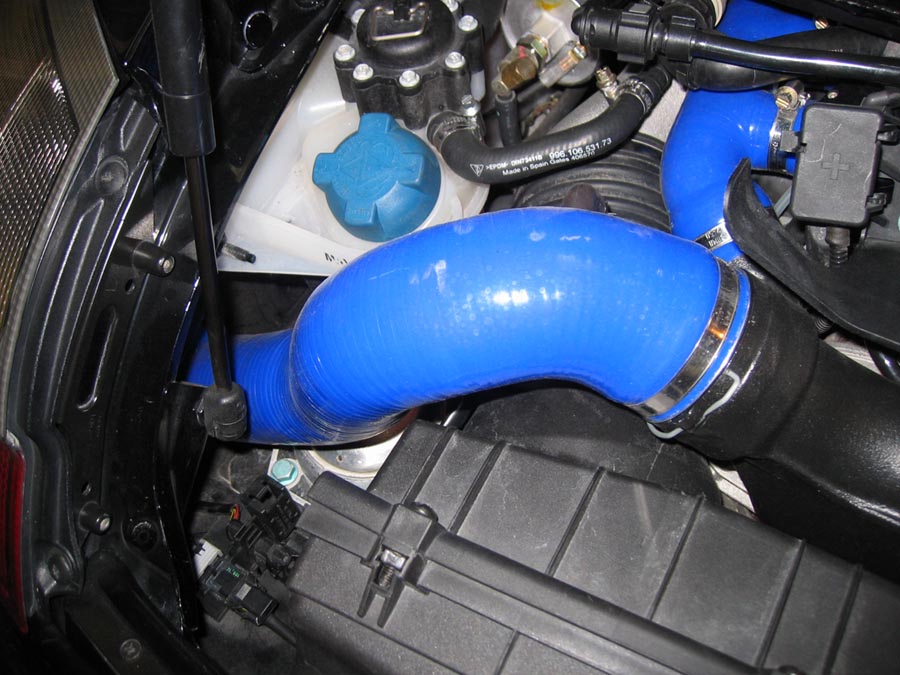

Originally Posted by ShokWaveRider
I am curious what the eBay "F" Hose Quality is like JeremyS?
The F hose fit well, with no trimming required. It's quite solid.
Looks Good! Better Clamps than AP Provide Also, I get mine from West Marine too. I may get the kit and replace my AP Hose with that one too. Then sell the AP one. I actually prefer the look without the white "AP" stamped on the side.
Did you have to remove the Intercoolers to replace the pressure hoses?

You dont have to remove the intercoolers to replace any hoses. You do need to remove the bumper to make sure the hose from the y-pipe locks into place in the intercooler though.
Don't have to remove the intercoolers, but, as ssmugen stated, you have to pull the bumper. It is a tight fit getting a hose clamp between the IC and the hole in the body that the hose passes through on its way to the Y-pipe.
I installed mine without removing the rear bumper. Just jacked up one side at a time. I replaced my bottom hoses back to stock after both at 1.2 bar. Could have been a bad batch. The F hose very rigid and no problems after 3000 miles. I left the top ones on because they seem to be holding well and look great. Mine are American made and top quality silicone hoses.
How much did you pay for these top quality American made silicone hoses? What brand are they?
When we mentioned taking the bumper off we were referring to clipping in the hose connecting the Y pipe to intercooler. That hose is very difficult to clip w/o taking the bumper off, i've done it and its a PITA.
The hoses hanging off the intercooler to the turbo can be swapped by only jacking up either side of the car.
Ah now this answered the questions I've had about these hoses. So the hose is a normal ended silicone hose with a machined aluminum piece to fit the stock fitting and then a normal clamp to secure it? Do the SAMCO replacement hoses work the same way - with clamps? If so, and if these are molded pretty well, then I'd use these if there were colors other than blue
Any chance T-bolt clamps could be used? I've not looked at how tight things are underneath and T-bolt have to be bought pretty close to the correct size to work but I've had excellent success with them in the past. NAPA, believe it or not, sells GOOD T-bolt in stainless for CHEAP. I had HORRIBLE issues blowing hoses on my Supra and two things fixed it - T-bolt clamps and cleaning the insides of the hose mating surfaces with methanol. Once you remove ALL grease silicone becomes so sticky it's not funny. Removing them became the real problem after I started doing it right :-) That vendor doesn't seem to have any for sale now though, just 997 hoses in that bright blue. Another vendor has a near identical item for over $400, it must be better! ;-)
Since it seems the OEM hoses can hold fine what exactly fails about them? Is it simply the ends leaking?

You are correct - it's a machined aluminum piece that the hose slips over and is then clamped. There's not enough room for T-bolt clamps though. The flanges are too narrow, but they have a big lip that makes for good positive retention. I have plenty experience with 1.6+ bar on other cars, and have 0 concern about these blowing off. Just keep things clean like you mentioned, and get good clamps (I like ABA) and don't worry about it.

I did see a pic finally of a SAMCO hose and saw that yeah it uses clamps so that helped! So long as the surfaces are clean and sticky it ought to be good, shame the flanges aren't wider.
I agree, the boost these cars run is kinda' low from what I'm used to - at least so far but it seems to be increasing as people find out the motors aren't quite as fragile as first thought. Kinda' like the Supras ;-)
Anyway, these cheaper hoses actually look decent to me and it would be nice to hear from others running them. The SAMCO stuff is top notch but geez they're expensive! However I'm hoping my boost hoses are fine so I can skip worrying about which ones to get altogether.

The reinforcement material is what makes it strong and less prone to pressure expansion. Also you have to take into account temp., pressure over time. All the hoses mentioned here have polyester or nylon reinforcement. The more material used, the lower the quality of the silicone. And yes, I do own a silicone company.
I've never liked the way Porsche connects all of their turbo tubing to the ic. Back in 02, I kept having a problem with a hose popping off of a GT2 that had a bunch of power mods.
