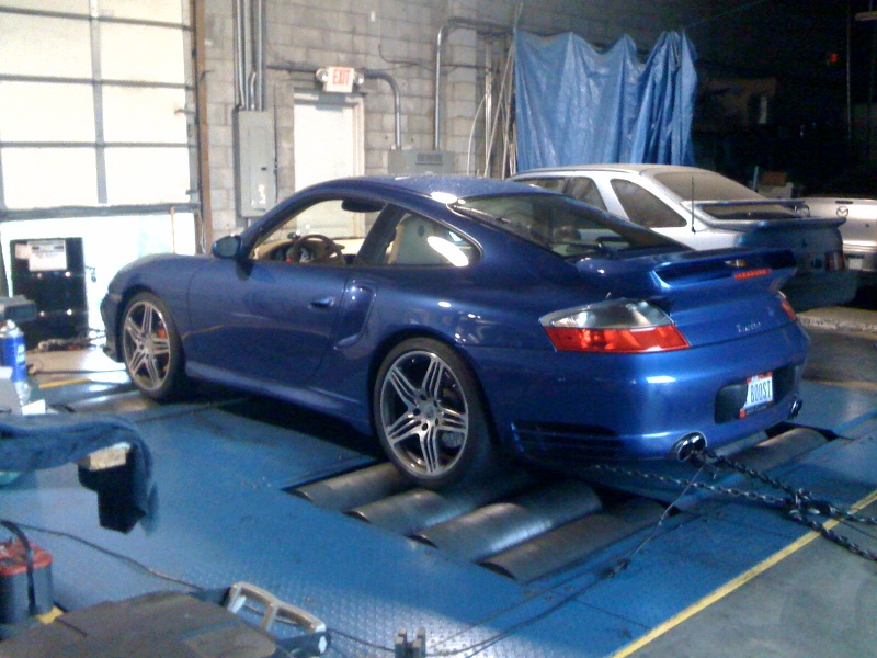

I have a 2003 TT with 997 Turbo rims. Work fine.

Ooooooooo, those wheels look really good on your blue car Viprklr.

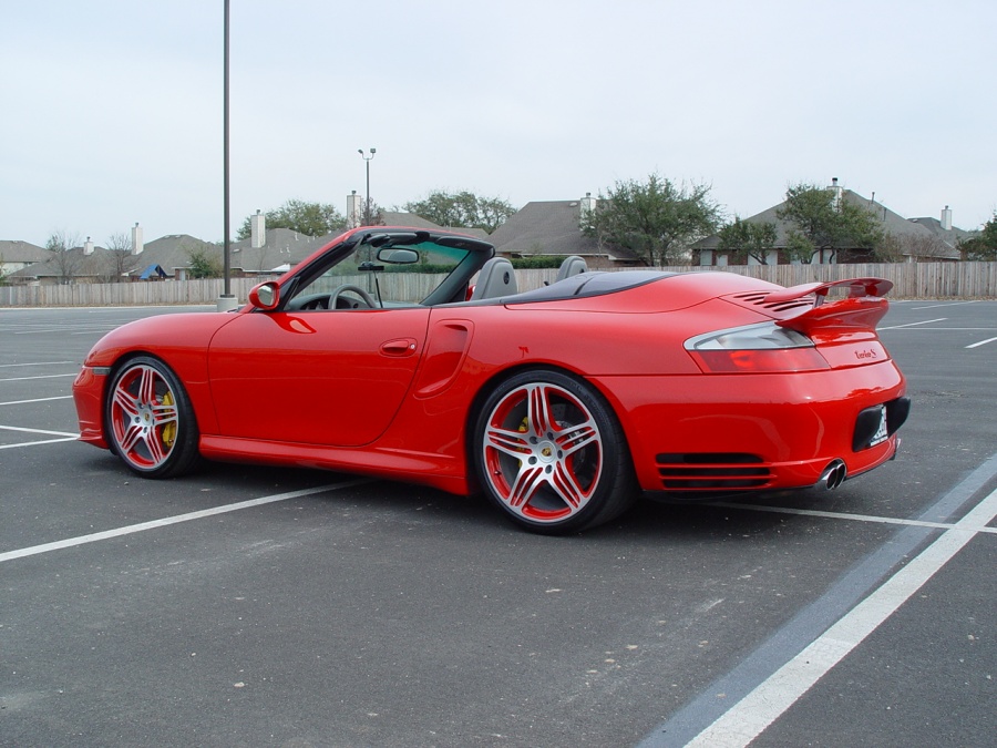

Wow, I have never really been a big fan of the 997 Turbo wheel design but some of the 996 Turbos on here with the 997 Turbo wheels look great!
