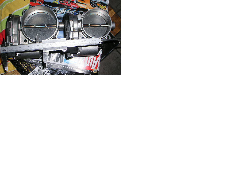

I have a Cayenne tt 2008 Throttle body with 82mm....it works with my ecu
now I am searching for a ipd plenum that support this diameter...my intake system (y-pipe) is from speed tech and great enough for this 82mm throttle body...
attached the pic from a oem 996tt tb and the Cayenne tt 2008 82mm
