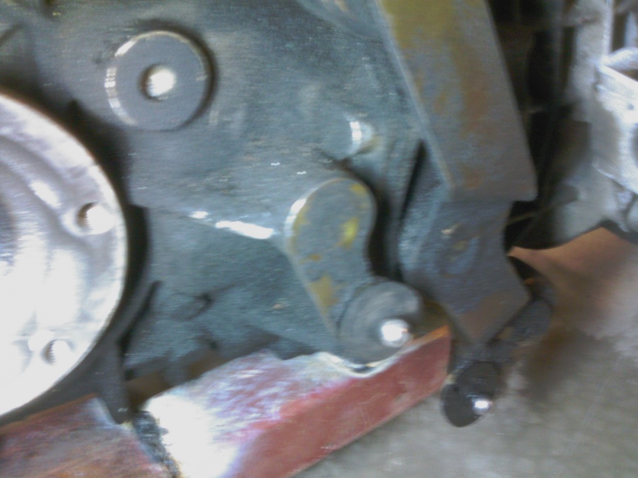

Well I finally drop the engine and trans today. It is a bit more work then my SC. But not that bad. So now I need to decide how I'm going to spend my limit budget.
1 - GT2 clutch slave upgrade
Slave looks like it is leaking. See mobile phone photo.
2 -Turbo rebuild and G16 upgrade - flash and FPR
3 - Repair the leaking seal or bushing on the the large shift linkage. It has alot of slop. Anyone else seen this problem? If so, does the box need to be oppened to fix it?
4 - DV upgrade
Any other Ideas for upgrade without going to K24/G16?
Thanks
Ron
