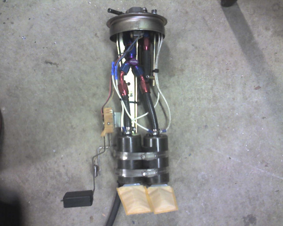

This is the kind of stuff that gets done in the Supra world, at least MY Supra world. Paralleled 2 pumps and welded -6 & -8 fitting onto the pump assembly, maintaining all the factory plugs. I did keep the fuel pump control in the AEM standalone. Can this be done or is this what you guys are doing?
That can be done but since the top plate on the porsche is plastic you would make one in metal. 2 044's will not fit into the stock porsche pump basket thats the next problem.
but I know 4 walbro's will fit
Thanks Chris. Eventually I'll rip mine out and see what's doin...
