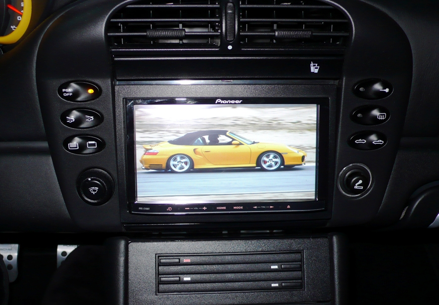

I do my own installs, never found anyone that does the kind of work I will do on my own car. (one exception here, when it come to mods for HP, Sharkwerks treats the car like it is theirs). Labor is expensive if you want the job done right. Save your money on the component side, buy off the web. Pioneer AVIC-Z110BTs are going for around $900 and the amp I just bought was $300 for 760W into 4 channels with active crossovers built into the amp. The second amp 350W in the photo is just for the subwoofer.

The Avic-Z110BT is a great unit. Your picture of the install looks awesome, but I bet in person it looks 100 times better (at least mine looks sooo much better in person).
I am not handy enough to install, but found a reliable guy in Chicago who does top notch work. I had PCM1 - no MOST. Install was still a little different based on what he told me. I did not do amp/speakers for now. He also made a custom trim ring. Pictures do not do it justice. I wish I did this 3 years ago. Sounds a 100 times better through all the factory gear. Here is a really bad camera phone pic. I will post a decent picture when I get a chance and the top radio shelf is installed.
