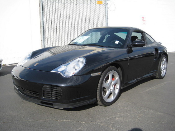

It arrived today at my doorstep. We had 4" of snow last night, but the sun came out in full force and melted/dried all the roads. I was out all afternoon enjoying the new car. What a beautiful machine! The car is already filthy. Black will certainly be a chore!

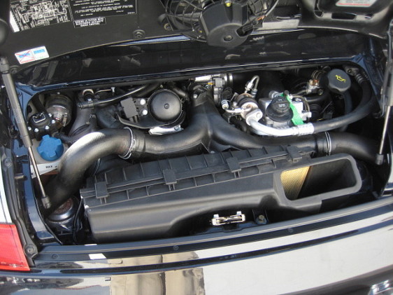

One more thing... the picture looks like a stock air filter. A K&N filter is an easy upgrade that should be done, especially if you get a flash.
Are you talking about a drop in filter, or Cold Air Intake?
No, just change the factory filter every other oil change and you'll get the 99.95+% filtration the engineers specified. K&N is crap filtration, as is most of the 'performance' filters.
No need for intake mods until you are beyond 600HP... No intake has been shown to improve performance in any appreciable way under that level.
