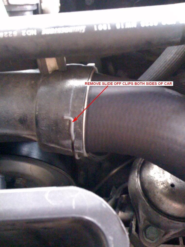

Step two
Undo intercooler pipes as shown below by sliding out the clips.

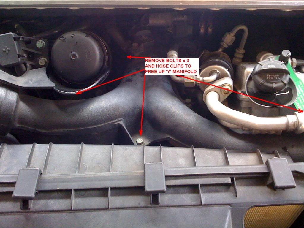

Step three
Remove all pipes and connectors attached to the 'Y' manifold carefully and push out of the way. (NB - Picture below shows airbox which would be removed by now)

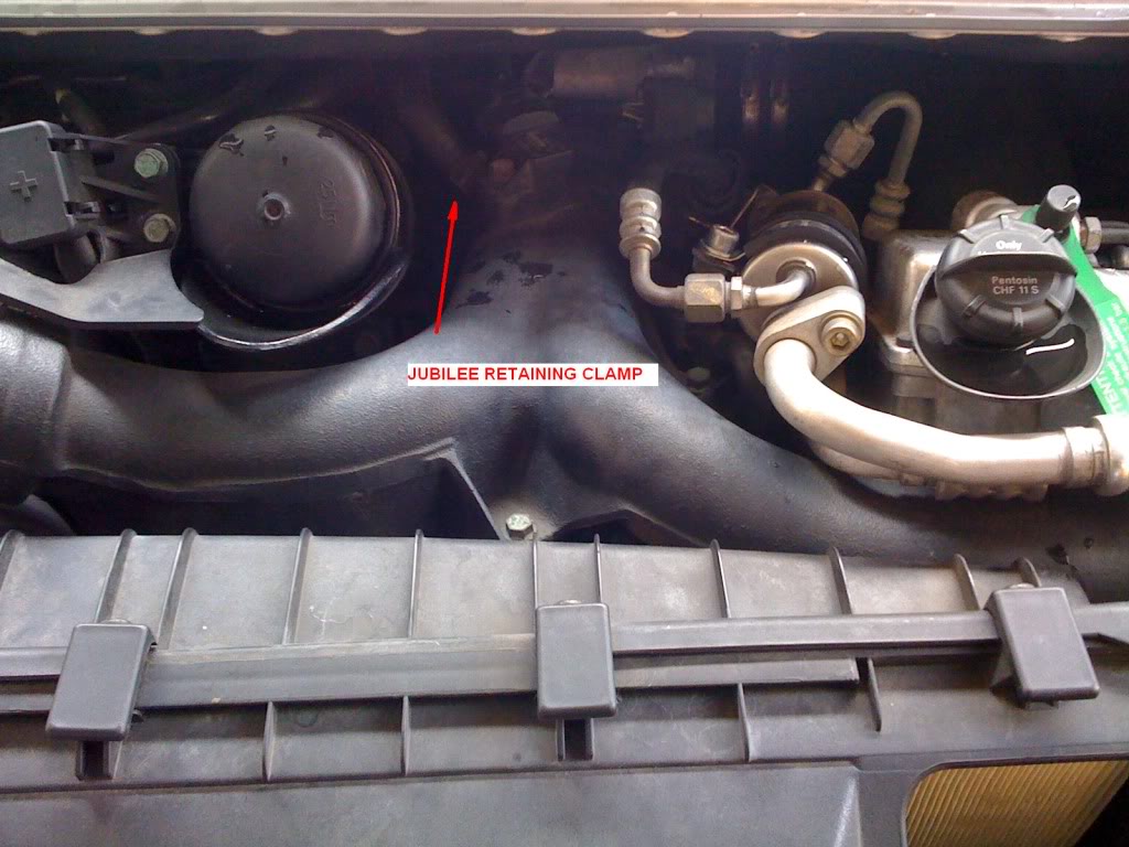

Step four
Undo jubilee clip at top of 'Y' manifold just before the throttle body as shown below (Stumpy screw driver or socket set required here)

Step five
Gently wiggle and twist 'Y' manifold - it will pop off. You only need to move manifold to the left half an inch or so once removed to get access to N75 valve - it remains attached in place. You will now see the N75 valve as below

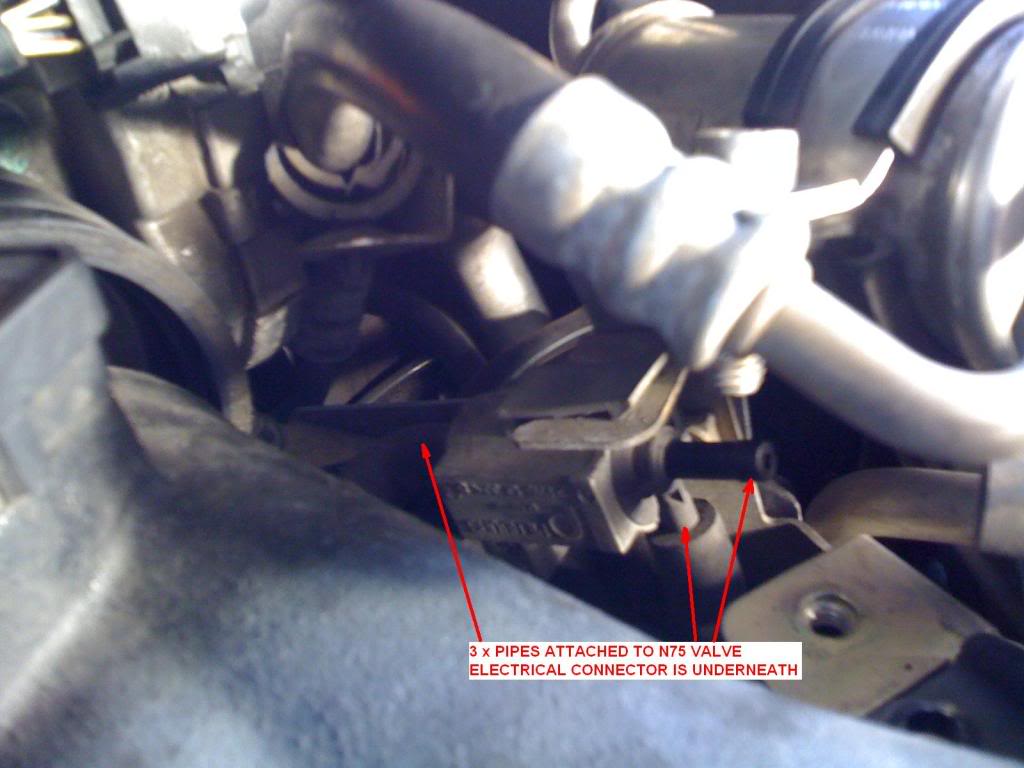

Step six
Slide off the 3 x pipes attached to the N75 valve
Sldie the valve off its mounting and lift it out a little
Unplug the connector below after removing the metal retaining clip

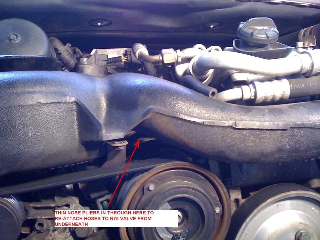

Step seven
Reverse the above process

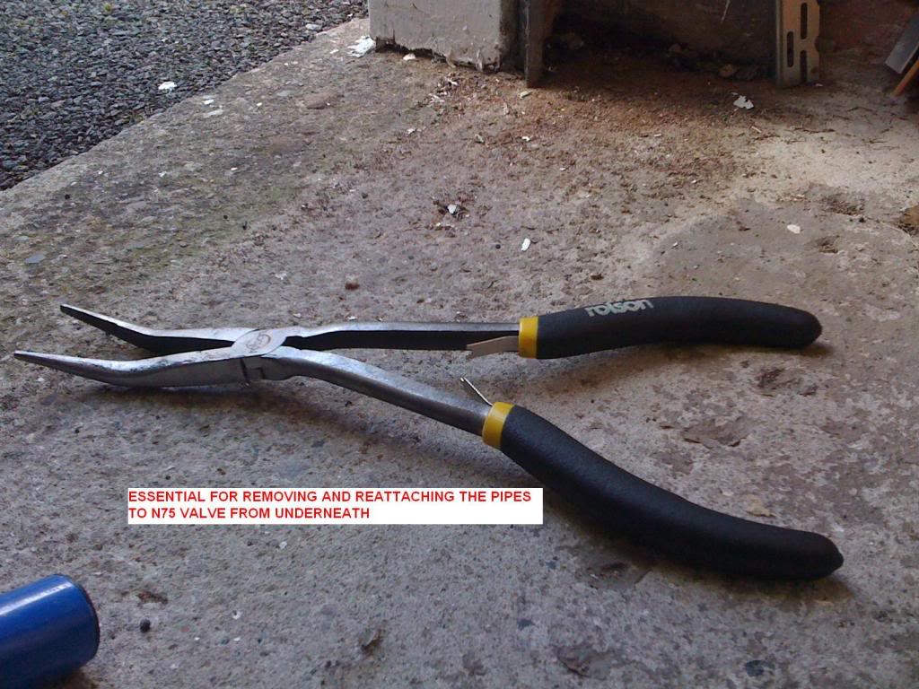

The only tricky bit is getting the pipes back on to the N75 valve - you really need a pair of these or its a PITA to do.
The bottom pipe needs to be pushed on using the pliers through this gap (it will make sense when you do it)
