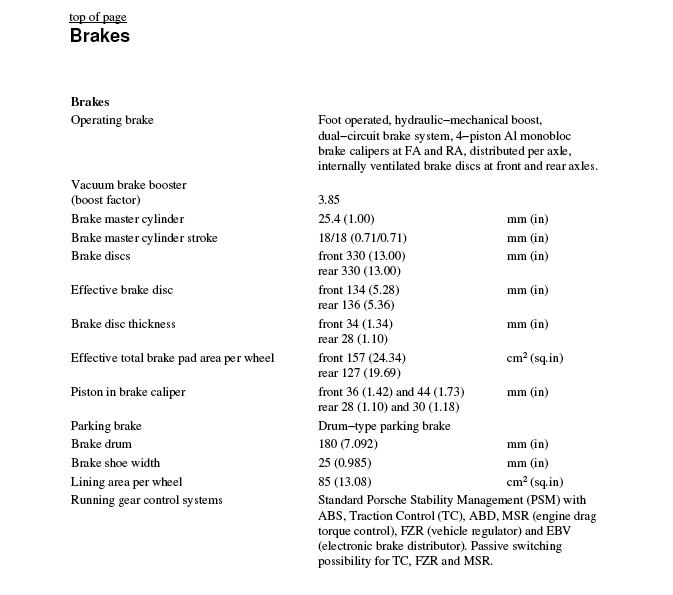

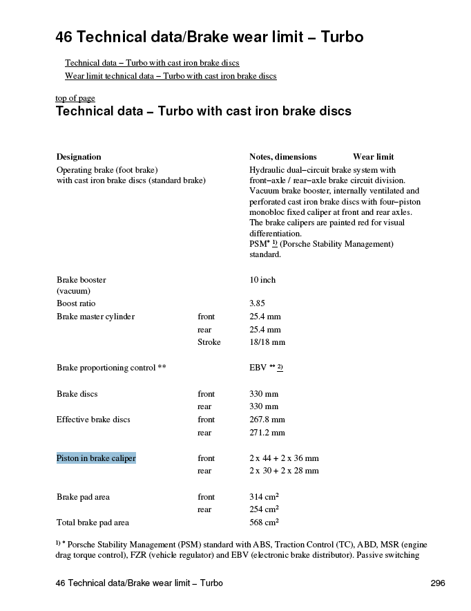

Found in repair manual....
Pistons size.... I am surprised to see the front and rear have two different size of pistons....front 44mm 36mm rear 30mm 28mm
That's what I remembered, but I didn't want to give him a bad steer without looking. The difference in piston size builds in a front brake bias 65/35 (that's (36^2 + 44^2)/(36^2 + 44^2 + 28^2 + 30^2)).
