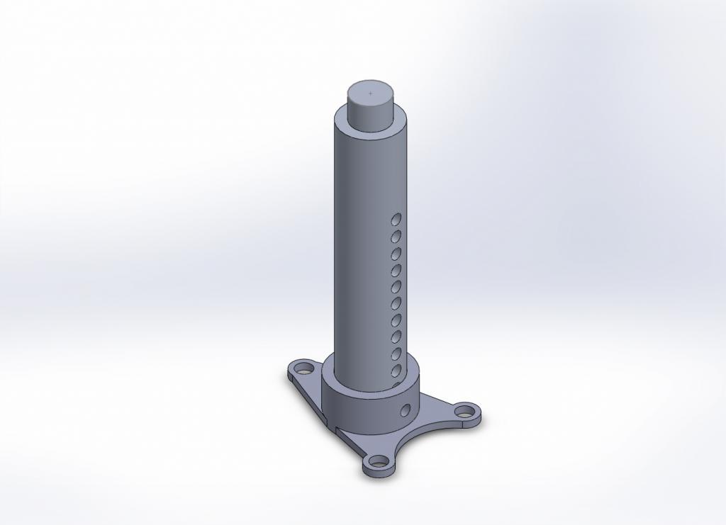

Version 2.0 adjustable

I don't suppose that top piece can be machined to have the "slit" in it like the factory rams? I have an aftermarket "GT2 add on" wing, and the inserts are not removeable to swap with the factory ones.

Is this the hardware of interest? I like it, sure as heck beats the hydraulic set up and the $1500++ GT2 option.

Yes... i no longer have 996 mounts. Only 3 997's. New, revised fix wing mount will be adjustable, email me for more info if you want to put a deposit at a discount
